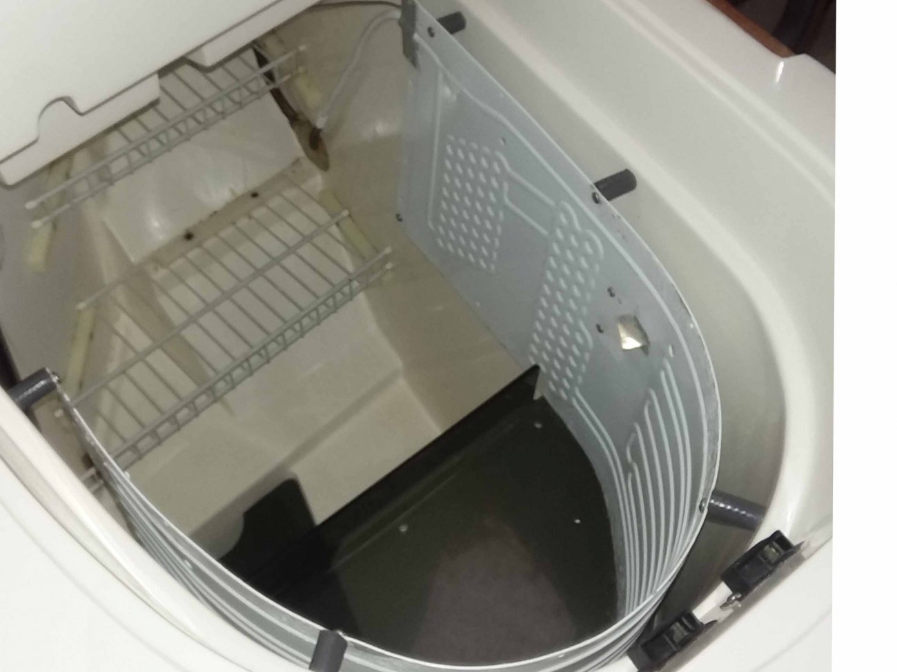

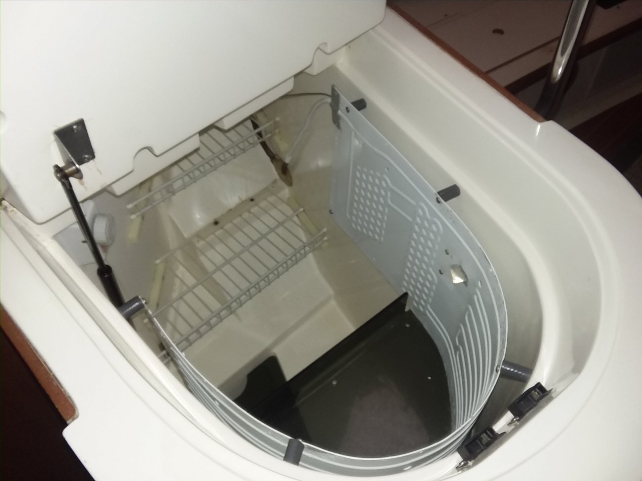

Hi all, aboard my Hunter Legend 43, the R12 Adler-Barbour DCM-12L compressor unit for the large refrigerator has gone out so I am looking for a drop-in replacement. The real problem is finding a replacement for the 40"L x 11 3/4" horseshoe shaped evaporator plate for the refrigerator.
Has anyone replaced their 40"L x 11 3/4" horseshoe shaped refrigerator evaporator plate and if so what was the non-R12 replacement solution?
Attached are pics of the evaporator place and compressor unit.
Thanks!
Mike

... The real problem is finding a replacement for the 40"L x 11 3/4" horseshoe shaped evaporator plate for the refrigerator....
There are basically two families of evaporator. They are parallel & series. It is common practice to replace parallel evaps after a compressor pukes its guts & contaminates the whole system with sharp little pieces of itself, because it is very difficult to reliably clean out parallel flow components & any shrapnel left over in the system from the failure of the old compressor can ruin the new compressor or other downstream components. With series evaps, normally a good flush & blow out is enough to return it to service, provided that it does not have other obvious problems, like having a lot of visible corrosion or a case of the "black death" inside. If your horseshoe evap looks good, it may be worth saving.
If the evap has an oriface tube, receiver/dryer, or other filter device upstream & the oriface tube did not get clogged after the compressor failure, then the evap probably did not get contaminated with particles at all.
A series evap is one that has all the tubes in a single line. A parallel evap has 2 main tubes, with a number of little tubes in parallel between the main tubes. It is not impossible to clean out a parallel evap, but it is difficult to do. Confirming that it has been properly cleaned is almost impossible.
Flushing AC components properly requires the use of a nasty chemical cocktail that is simply call "AC Flush". Depending on which area you live in, it may be a regulated item. In some parts of the US, it is still an over the counter item, or at least it was the last time I bought it.

850 bucks from defender...Isotherm Compact compressor and evap plate...you bend the plate to fit, wire it up, and turn it on. Replacing refrigeration was my very first project...easiest one so far!
