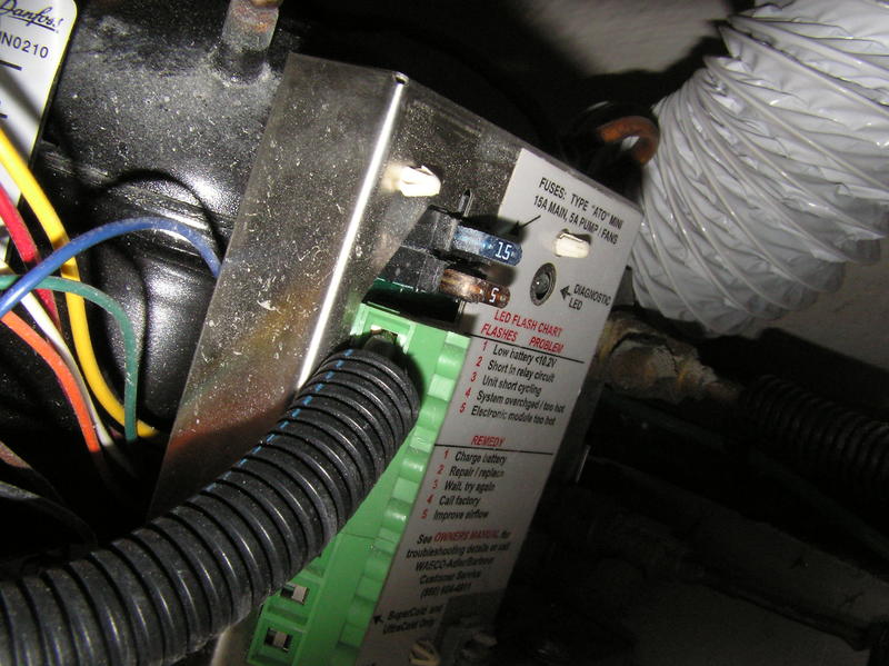

Hi,
Did anyone experience problem with their Adler/Barbour fridge?
I am getting the error code 3 on the controller LED. I am wondering if it is the Danfoss controller module or the compressor itself that is faulty.

Thanks Stu
The info available on Kollmann-marine were of great help.
The troubleshooting error code provided by the controller LED was not accurate. It was pointing the compressor has being the problem, but in fact it was the controller itself.
Prior to buy any new parts, I borrowed a controller from a friend and it solve the problem. Many boats are equipped with this common part.
So, it has been not so hard to troubleshoot, and not too expensive to repair by myself.

I've been dealing with issues on my unit all summer, (well Tech has at my $$$$) Where do I look to see these flash codes? Is this obvious to the casual observer?
