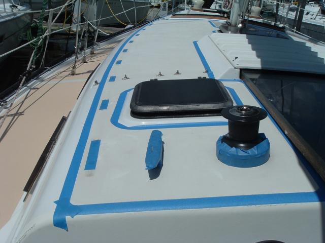

As Bill points out the "running backstays" should have a snap shackle at the bottom. The boat came with that attached to a single block with a becket and a cam cleat. About four feet higher should be a double attached to the wire. I keep my runners slightly behind the aftmost shroud. You can barely make it out in the picture, the green/white line just ahead of the jib block.
I only move the windward runner when sailing before about 15 knots or more. With the big yankee and the main hanging way out there you want some extra support. This is especially true with an assymetrical. I probably haven't moved one more than five times in the twelve years that I have owned her.
