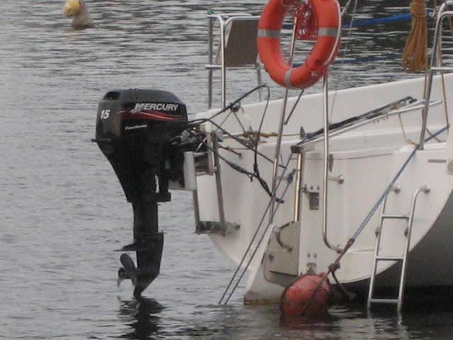

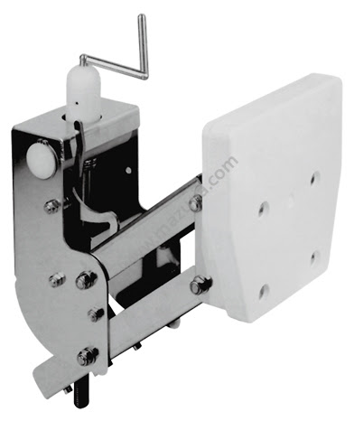

Bosman, your fourth pic down is similar, wide like mine. What is the brand name and distributor?
Trinkka, I like the bracket in your third pic down, my question is how hard is it to push the release lever to raise the motor? Looks like it has several locking positions, and is that black taped object there for safety reason? What is the brand name of this particular bracket and who is the distributor?

As I mentioned previously David, I never need to touch my outboard bracket once I have it set. I'm able to just tilt the outboard up on it's own bracket. I wouldn't want to have to depend on that Fulton outboard bracket for raising the engine up. They make a more heavy duty bracket which has a better handle on it than the one I have on my boat now which is a Panther bracket.
Tilting my outboard up on it own bracket isn't too bad David. I only need to swing the outboard around with the handle down, and pull the top of motor toward me and reach around with my left hand to lock it in place. To tell you the truth though, there isn't that much room to get that engine tilted up like that. It just makes it.
That black taped bar is my engine lock bar. I spray the lock with WD-40 and use duct tape and black vinyl tape over the lock to keep the water out.
That particular bracket is the Fulton bracket that came with my boat. My friend Del gave me a Panther bracket which I installed last year. I was amazed when I found out that the bolts all lined up. The 8" Beckson Deck plate that I installed on my inside transom made it simple to change out the bracket. Here's a pic of the Panther outboard bracket that Del had on his Hunter 27. It's a lot newer than the Fulton bracket that I had on there. I gave my Fulton bracket to one of our new YC members who owns a Mac 26. His bracket looks older than the Fulton and it's not adjustable.
