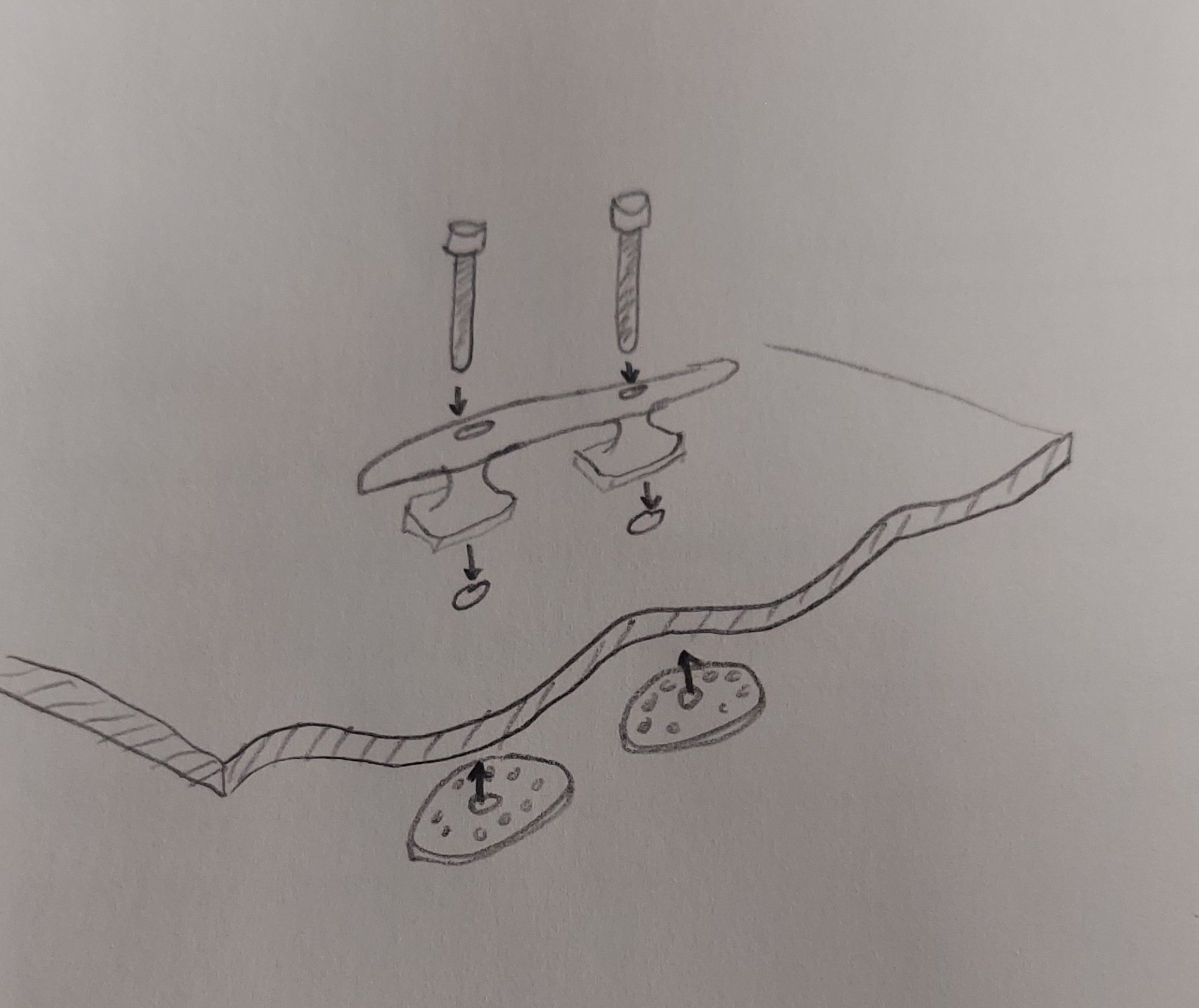

I was thinking more for structural hardware, in a sandwich with the deck (pictured). Effectively giving you a permanent threaded hardpoint in the deck.

Thickend epoxy or Plexus. I've used both, zero failures. Not cleats, but holding down an AC unit and many hooks that see over 100# in shear.
Where did those come from?
Another proven option is to thread + epoxy the studs into 1/2" Garolite pads.

For installing cleats and such the deck will need something solid in lieu of balsa or foam coring. Tightening the bolts would crush the core otherwise. Do you intend to remove or de-install these items? That might lead to them leaking. The expense and effort involved with installing the nuts or studs might be considerably more than simply using tape to hold standard nuts & washers in place when you install a fitting, too.

Going through a 40 year old boat... yup, I plan to remove and re-seal everything. The flanges on these are 1.5" across, should be suitable for shear loads. Backing plates will still be needed for things like halyard fairleads etc.

i like those fasteners, but question whether there is enough room under the deck for them (stanchions are pretty close to the outboard hull). And certainly it seems like a lot of effort for something I would hope to remove and rebed once (if done right). If the fitting is removed frequently, that is a different story I guess.

For my winches, I chose 1/4 aluminum plate to back the hardware. Cut in a shape that fits the space under the cockpit combing as a backing. I drilled the hole pattern to match. 8/8 inch plate cost $19. One of the adhesive mount nuts described cost $17.59. I could not fit 6 nuts in the allotted space.
Nice idea but a bit pricey for the desired task.
