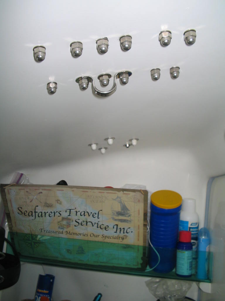

My B323 came new with the "spinnaker package"- a winch a line stopper and halayrd IIRC. The winch is through-bolted, so has large washers, and acorn nut in the head ceiling. I suggest an eye stap or two as a place to for a coat hanger when changing clothes. The aqua color shelf is one of 3 I adeed, made by a plastics place in Annapolis. Lots of storage there. I have 12 line stoppers on deck, 6 per aside.

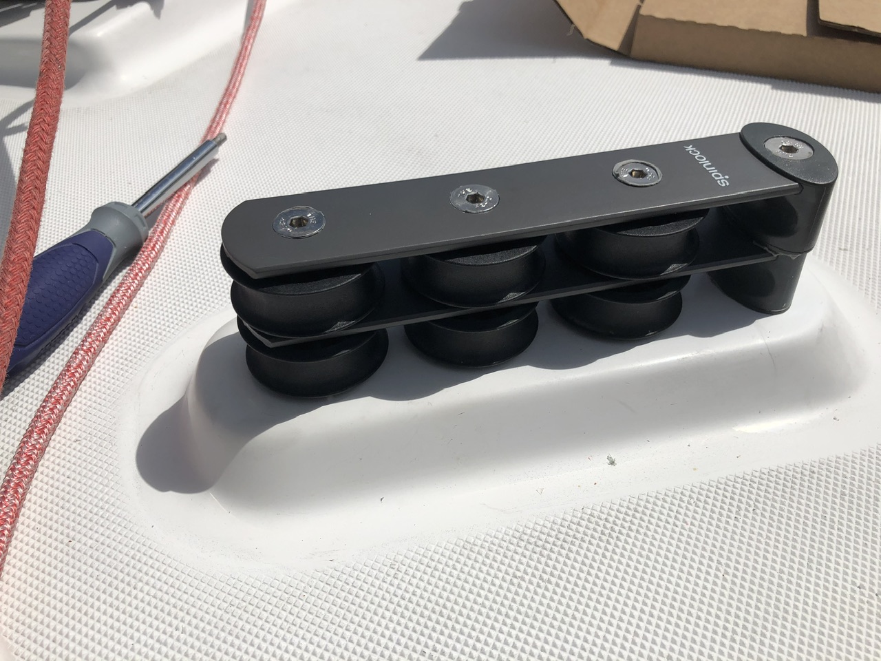

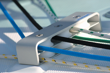

Spareparts.beneteauusa.com shows your original 6 sheave organizer as part 015973, but says it’s obsolete, so you can’t get it from them. Looks like the current Schaefer equivalent is available here - Schafer Schaefer Deck Organizers. Or you could get a Spinlock model, something like Spinlock T-Series Deck Organizers which is stackable to 2 high. That’s what Beneteau used on our 37.
If the hardware was available as an option from the factory on the 323 then you’ll likely see places on the deck where there is no non-skid, right where the hardware should be mounted. Those areas are solid glass, so you can through-bolt without worrying about core. If not you should overdrill the holes, fill with epoxy, then redrill before bolting.

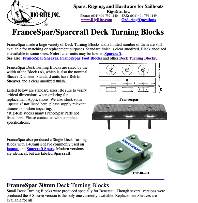

Try this site to see if it leads you anywhere. It's a very basic web site, but I bought some old parts for our 1990 Beneteau from them, they do have information on international shipping on the site. Rig-Rite, Inc.

@Ron20324 Thanks for the pic, I was looking for that.. will give me guidance.. do you have a traveller? and how many bolts have been used for that? I guess the same as the others, through the head lining?

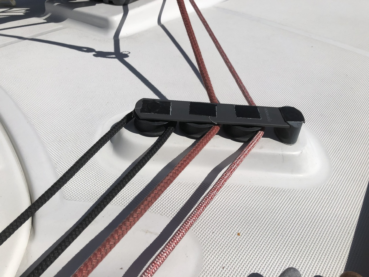

I think maybe you mashed Sparcraft and Spinlock together into Spincraft?
The 4 sheave Spinlock is available through this site’s store at Spinlock T-Series Deck Organizers. Other models say they’re out of stock but my guess is they can get them too.
Places like Defender have other Spinlock and Schaeffer models.

In my reply to the OP, I was specifically advising that I had found hardware from the same era at Rig Rite. If the Sparcraft organizer is obsolete and unavailable as mentioned in post #8 above, then maybe consider the Schafer or the Spinlock alternatives. On my current boat, I had very good luck adding a second stacked organizer to increase the number of lines handled on my starboard side.
