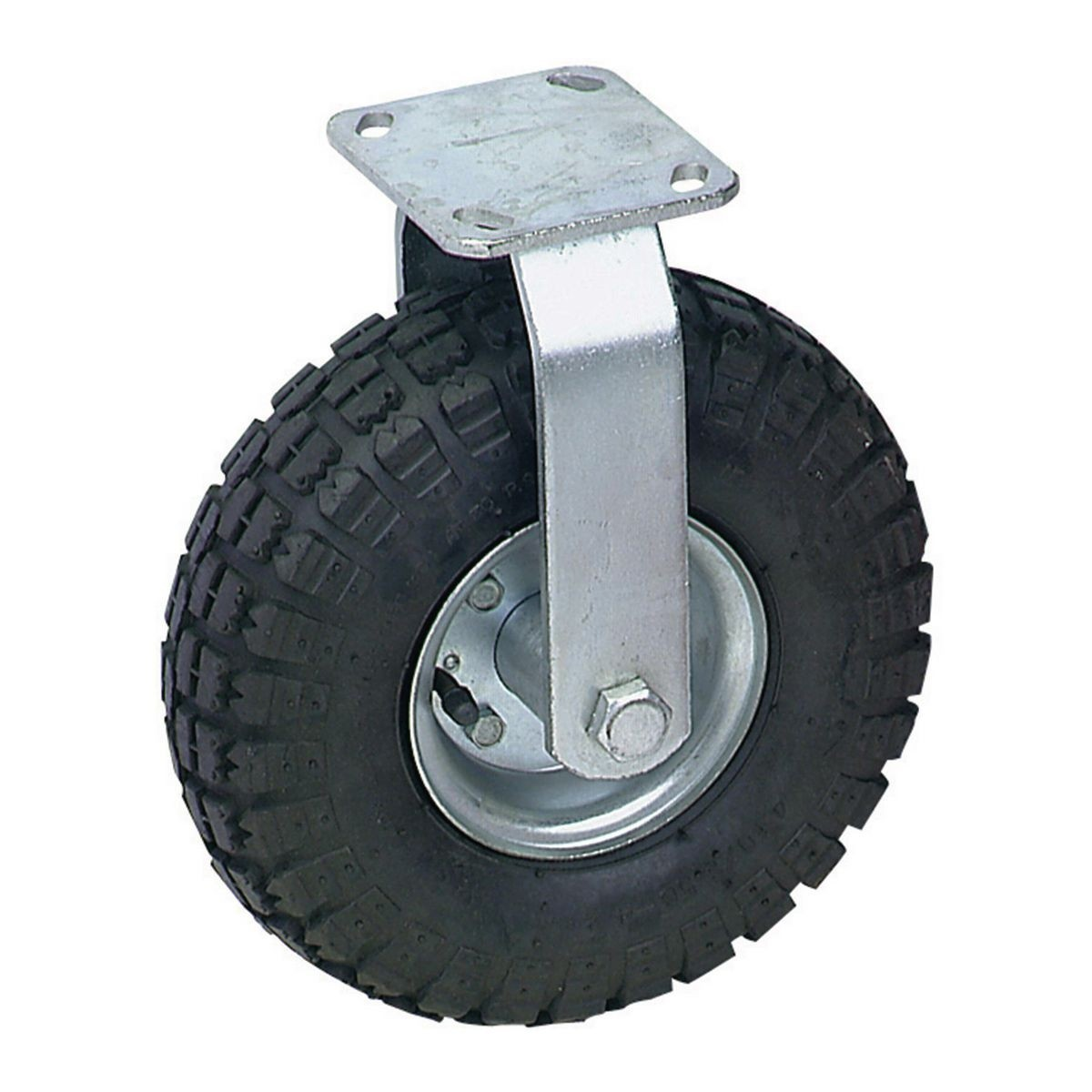

I like the options, but my dinghy is a Sumner dinghy that is double hulled so I am not sure I can mount the West Marine or the Davis stuff to my dinghy easily
I see plenty of fitting that go through the cabin top and though the inner liner. Is the inner liner of your dinghy made of thin material? I installed some non marine harbor freight wheels on the outside and a piece of wood across the transom on the inside. The fiberglass is sandwiched between the wheel and wood. Something like this could help spread the load if your inner liner is a bit weak. Wood isn't the best look but then again my dinghy is a piece of crap. These wheels are big enough that I can pick up the bow and wheel it to the dock
