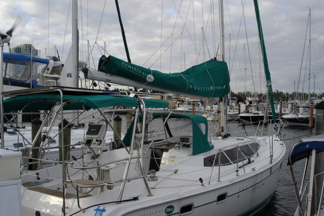

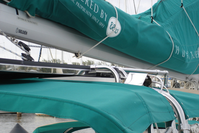

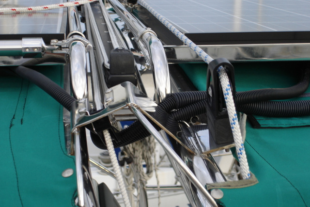

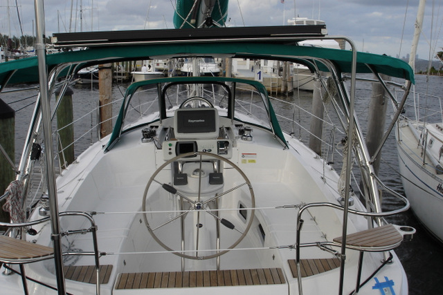

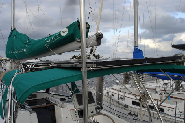

Has anyone added solar panels over the bimini and making any kind of bracket or support from the arch next to the travelar.
I did see solar panels on the new electric H-36 and stainless tubing was mounted to the arch some how but don't remember how it was done.
I saw the e36 at the miami boat show and they were doing some demo with the news media and did not get a chance to check it out,anyone doing this and can show photo's would be a good thing.
