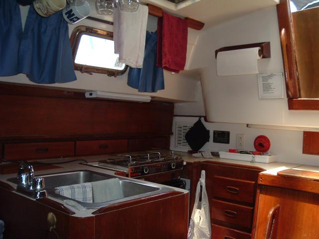

Benny is right. Previous owner had installed one in place of oven. Since I bought the boat in 1998 it has done yeoman duty. About four amps per hour on the inverter. But I unplug when daysailing and contents are still cold when I return to the dock in the evening. I leave it on when away from the boat so the beer is cold when I arrive. When motoring as we did so much on the way to Florida it stays on.
P.S. no good picture, it is under the stove. And I do have that latch to keep it closed on starboard tack.
