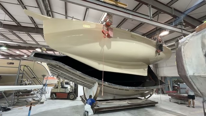

I put a 15x8" opening hatch in our hull.
I think you are over-thinking the structural and strength issue wrt the hull. Just look at the boat molds with hull ports - they just have a plug in the mold where the ports will go, then do a normal layup over this leaving the core out of the plug area, and cut out that area when the hull is out of the mold. There isn't any real structural design focus on these areas. Attached is a pic of a Catalina 316 hull mold showing this.
Many of them don't even do the above. They just cut holes in the hull where they want ports and install them.
Your hulls are strong enough, and the main strength to the boat is provided by bulkheads, stringers, liners, and other components that are designed to support a skin. The skin needs to withstand oil-canning, but any structural support will not be compromised by relatively small holes like you propose.
In the same vein, you don't need to worry about "hard spots" installing a frame around it. The hatch frame itself is a "hard spot".
The above assumes a boat designed with proper scantlings and layup, and not something like a Macgregor. For sure there would be no problems on a Mariner 36.

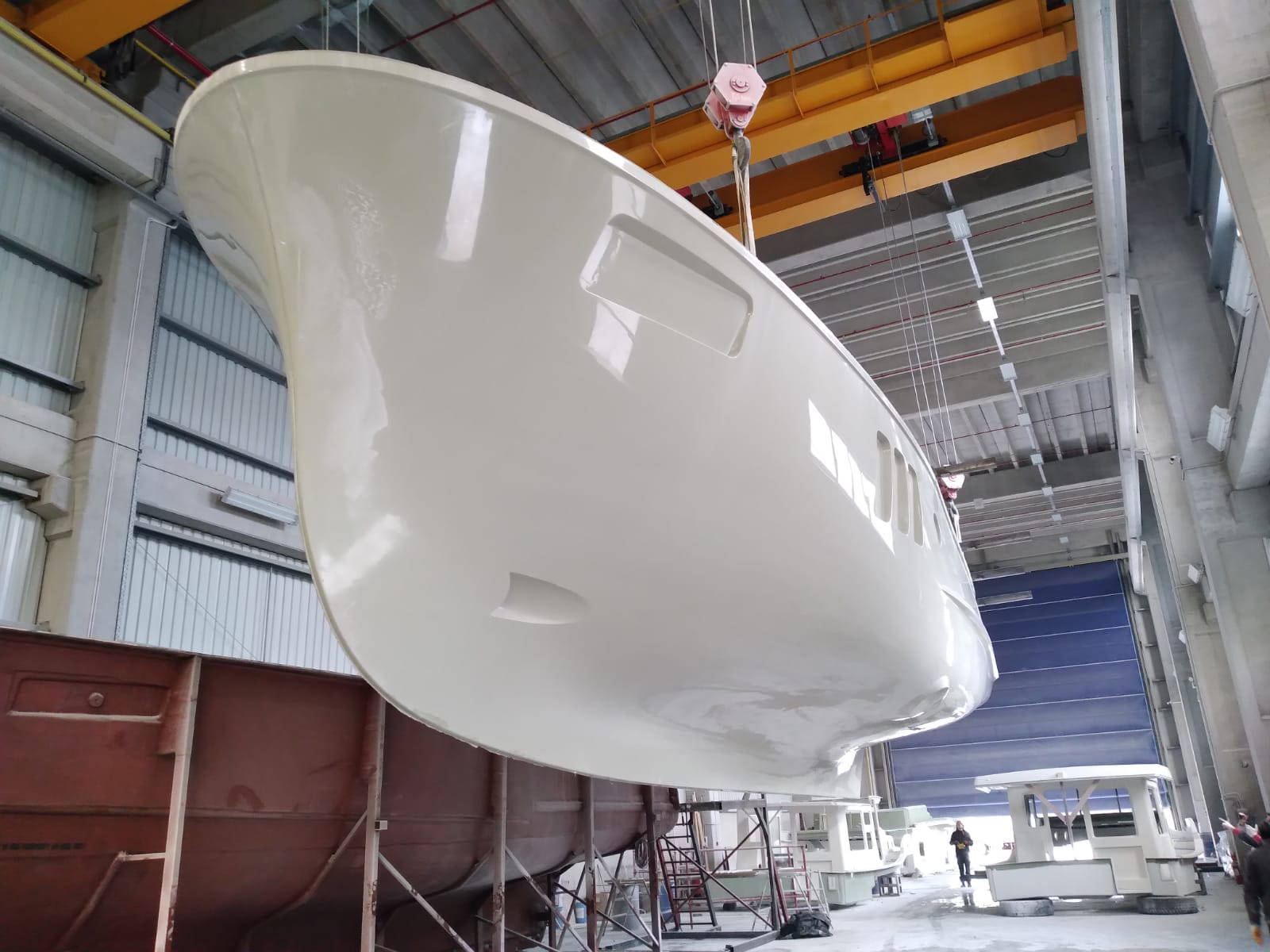

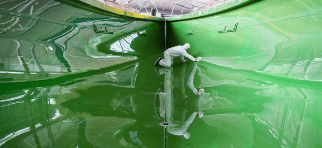

That Catalina pic with the port plugs wasn't very good quality. Here are some other examples, including what the ports look like when the hull is removed from the mold. Note that one of the examples is a male mold, where any additional hull reinforcements around a port aren't practical, as the port positions are areas where an external frame plug is employed, and the layup just occurs around it.

Thanks Mark. Ha! you might be right. I definitely over think/ over build everything. Thats really good stuff though. Thanks for sharing. I had no idea thats all they did. I have seen boats with hull ports, but its impossible to see what they did on the hull because its all covered up on the interior.
