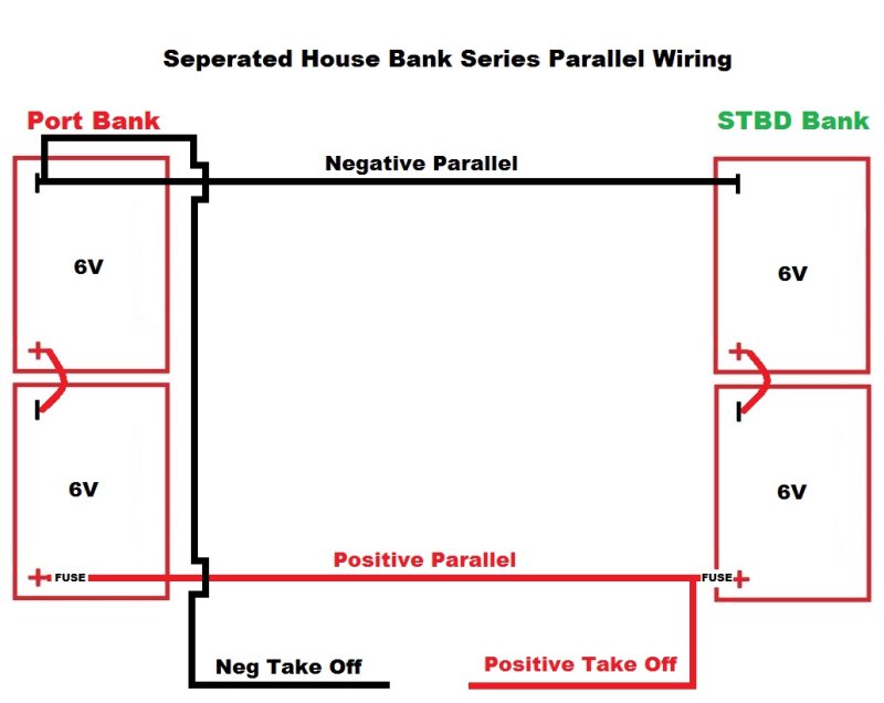

So, I read on RC's PBase site that it's not a good idea to add batteries to a bank that are not in close proximity to each other. I would like to add two more 6v batteries to my existing pair of 6v Trojans. I have space under the Nav seat about 4' away from the existing pair. It seems to me that with the proper cable sizing, I will not experience any significant voltage drop for a run of that length and I can properly fuse them at the positive terminals. My question is, what is/are the negative aspects of doing this? I have no more room under the quarterberth for additional batteries, so to keep them all together, I would have to dedicate an entirely new location for all of the batteries, thus entailing all new cables for EVERYTHING and in the process, the main cable runs would by necessity be longer than they are now. I'm not even sure if there is a viable option at present for another location.

some tomes you just have to do what you have to .......at the least you will have to up size all the cables if yours are not the correct size for the round trip run even the jumpers for joining the 2 6v in each set ...along with a larger negative cable and a positive cable and maybe even a larger alt cable to the maine bank...hope this helps
23,489
Essentially no negative aspects. You fuse the entire bank, not individual 12v sections within the bank. Just use the same size wires between the banks as used to the bank, assuming they are the right size to begin with.

As long as the positive take off and the negative take off are one opposite ends of the bank it can work. If your parallel wiring is more than "jumper length" then both sides of the bank need fusing.

Looking at your diagram I have a hookup question. My house bank is 2 4Ds, one in original spot aft of engine, the second in stbd locker. Cable runs between them ~ 4 ft. The hookup is takeoffs are both from the first bat. Second bat is connected pos to pos, net to neg. Is this OK?

i am not main but if you want full benefit of your charging circuit you need to do it like he has it ...that way it makes a complete round trip rather than charging the second battery by osmosis

Thanks woodster, looks like I now have another project to add to the spring list. The current hookup "seemed" to work during our ICW trip last year, but your explanation makes sense for a better charge.

Excellent! I have not done the requisite daily load calcs for my current power consumption, but I would like to add some type of 12v refrigeration. It would then seem prudent to have more than 110 AH of usable power. Would there be any problems with two newer and two older 6v's as a bank? How does one define "jumper length"? They will be +/- 4', so I'm guessing that's longer than "jumper length".

jumper length is usually 1 foot or less in most cases and iirc correctly fuses for the bats are supposed to be 9 or 7 inches from the battery post or directly on the post or stud
