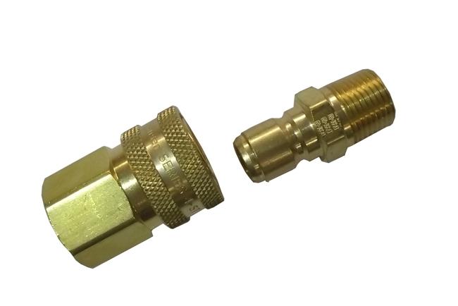

One option I planned for my Hunter 386 is to connect a y-valve OR tee to the tank. Then connect the existing LPG hose/regulator that goes to your cabin stove to the y-valve and another LPG hose regulator (with a quick disconnect connection if you want) that goes to your grill. No through deck fittings if you take the LPG tank locker cover off while you are using the grill. Check out the youtube video on how this was done on a fifth wheel trailer (same idea on a sailboat).
Jan 7, 2011
5,851
Oday 322 East Chicago, IN
The PO of my boat teed off the propane line and ran a line to the grill with a quick-disconnect fitting mounted in the engine control panel. To use the grill, I connect a line from the grill to the quick disconnect and turn on the solenoid to activate the propane.
the quick disconnect is like an air hose quick disconnect...
I don’t keep the grill mounted on the rail all the time, hence the disconnect.
i don't really like the set up, But it is pretty easy to use.
