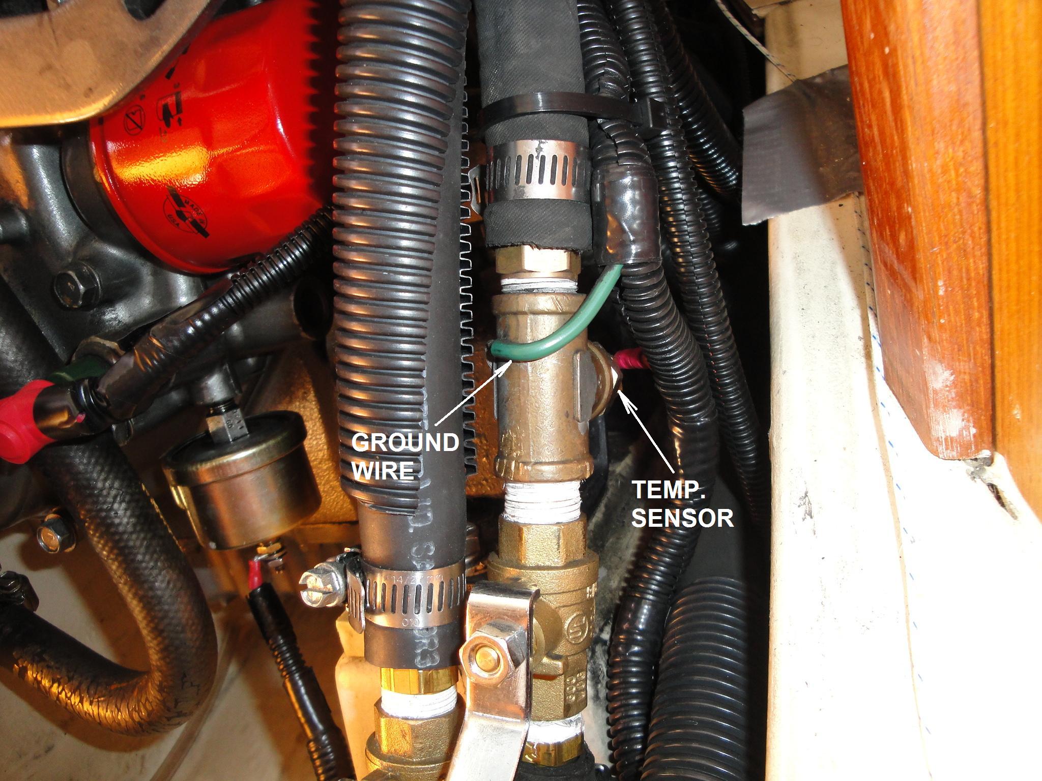

If your engine heats a domestic hot water tank, install a temperature sensor in the engine coolant outlet line. Watch the sensor ground line as the sensor will be surrounded by rubber.
If your engine does not heat a hot water tank .................................. you may be coughing up $265.00 for a new housing with dual ports.

Temp gauge would be good and added a temp gauge by putting tee in hoses going int to thermostat and been on my boat many years and very accurate and gives you what temp your system is
pretty cheap to do get gauge sensor and wire to cockpit.
