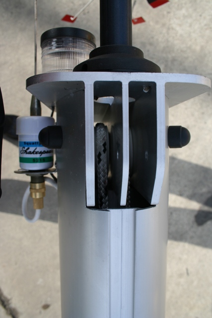

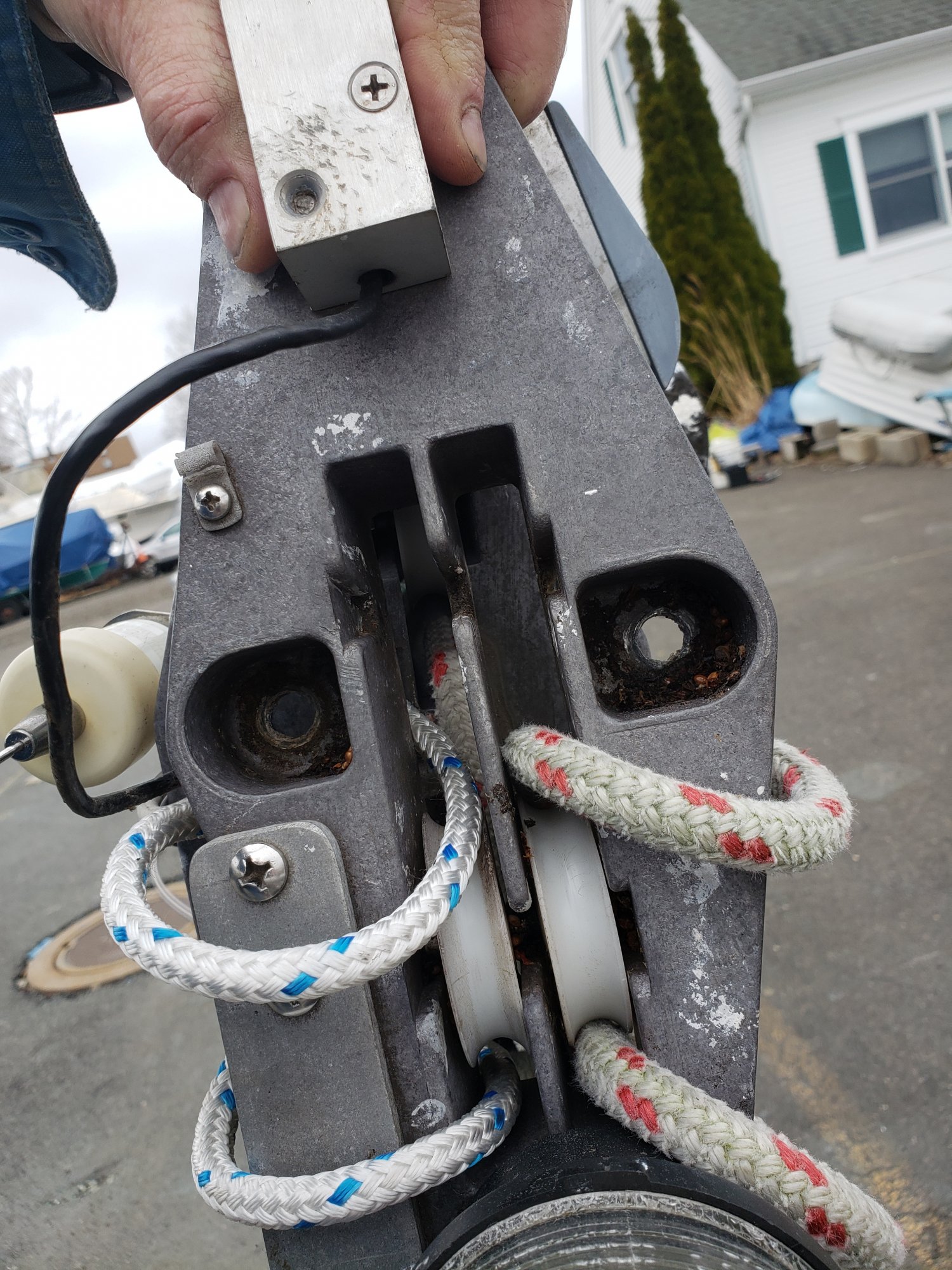

There are openings for four sheaves ,as I recall, in the masthead casting used on a 323. Its a US Spars mast.
The good news is that there may be an available slot for a sheave. The bad news is it would be on the same axle as the existing sheaves, and that is held captive by the mast extrusion. The only was to get at it is to drill the rivets out and remove the casting and there is no safe way to do it without unstepping the mast or hiring a bucket truck in my opinion.
I stand corrected, as Ron’s photos illustrate. Probably had the masthead and boom end confused in my pea sized brain.

My sheaves (1999 US Spars) were not riveted in and just held in place in side slots on the mast top casting.

It can be done! I did it on a 323 that was a 2007 model. Ordered the parts from the mast maker. It requires going up the mast and a hammer to install the wheel and shaft. Good luck and be safe.
