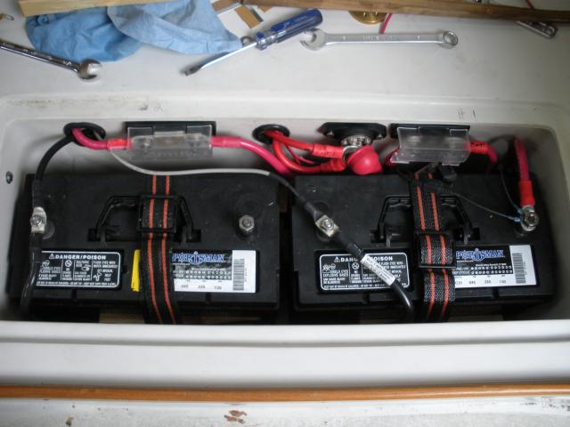

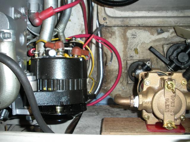

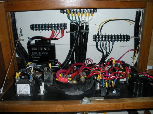

I just finished my upgrade as per Stu's recommendations. I ran the alternator directly to the house bank. I got 2 group 31's from Defender that fit perfectly in the battery compartment. Like you, I added a platform for a group 24 reserve battery under the aft birth. I went a little crazy running almost all new wiring I got from Boater's World going out of business sale. I did Mainesail's Leece Neville 90 amp alternator with a Balmar regulator, echo charger and battery monitor. I would recommend fusing everything.
