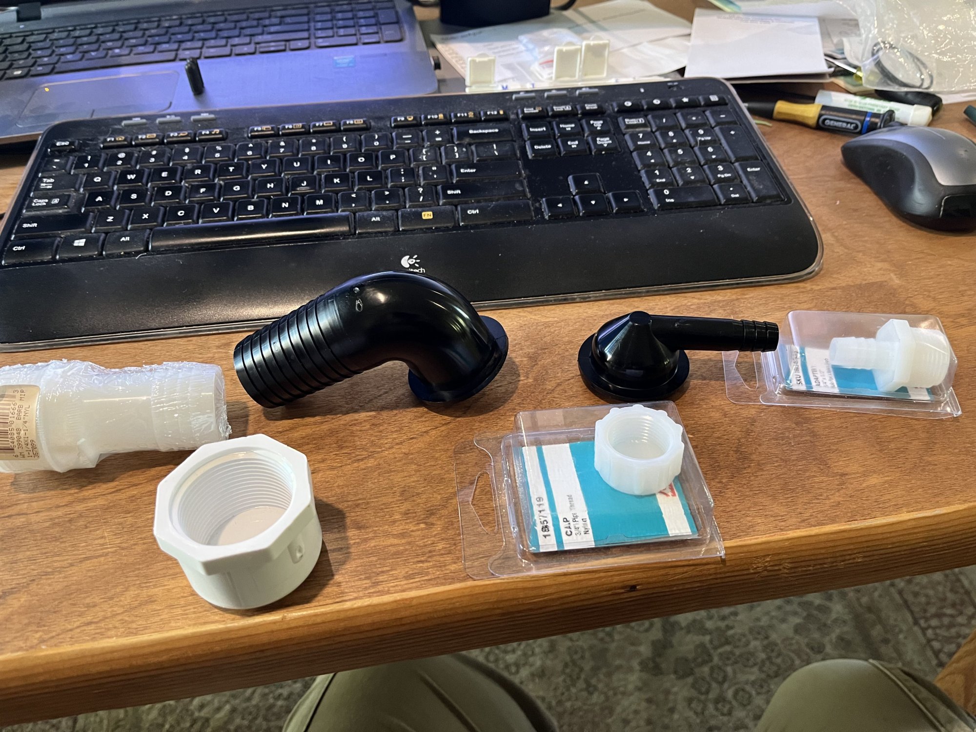

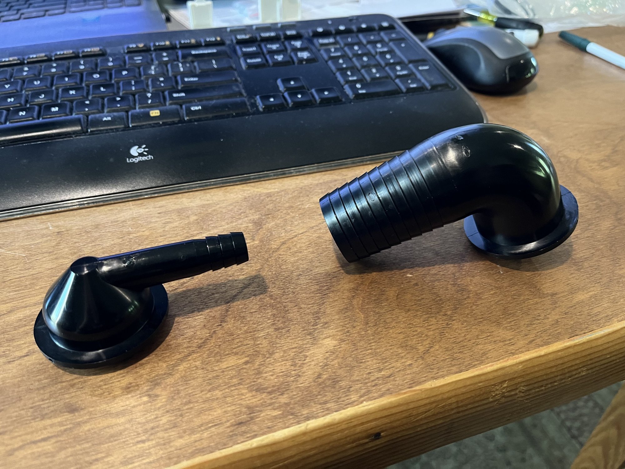

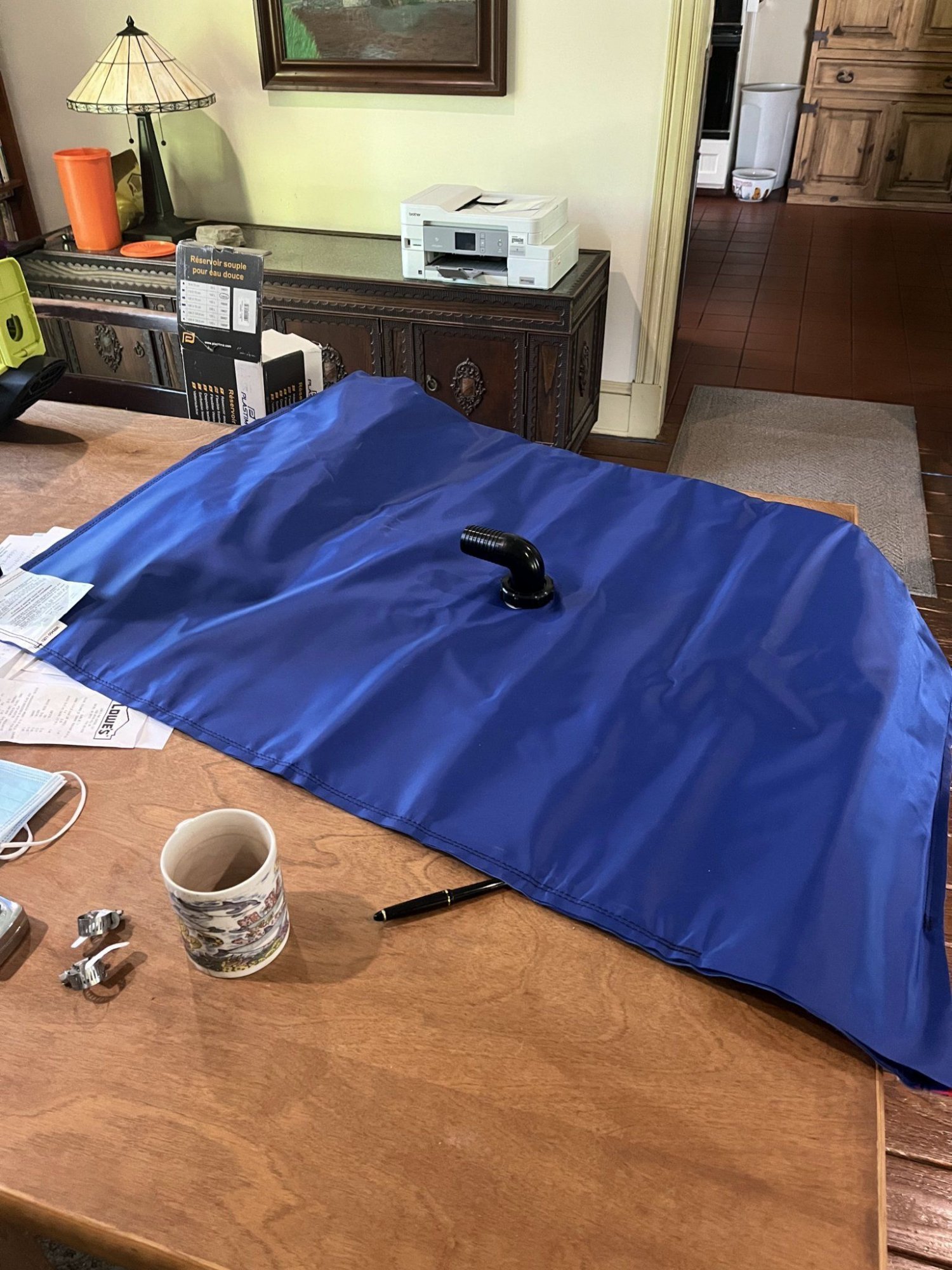

The tanks arrived. They are well made but there is no fitting to plug the openings. I understand that they a built as fresh water storage and set up to connect to an existing water system. There are two right angle barb connectors, a large for the center of the tank and a small for the bottom corner. I have purchased connectors and hoses. Had to reorder the large as I needed a 1-3/8 rather than the 1-1/2 PVC I bought. I will post pictures after it all fits together and is checked for leaks.Additional Connecotrs.jpgSupplied Connectors.jpg

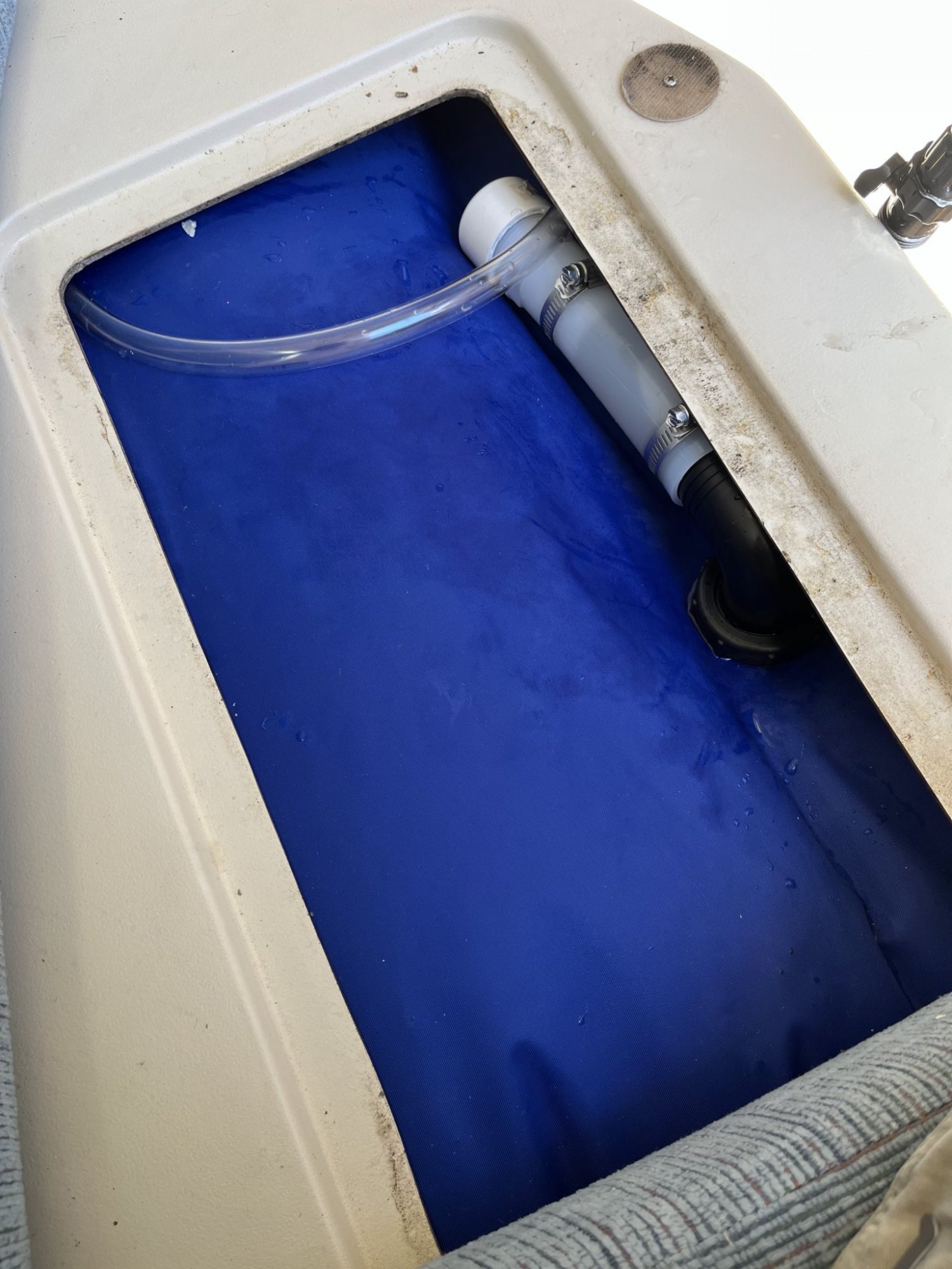

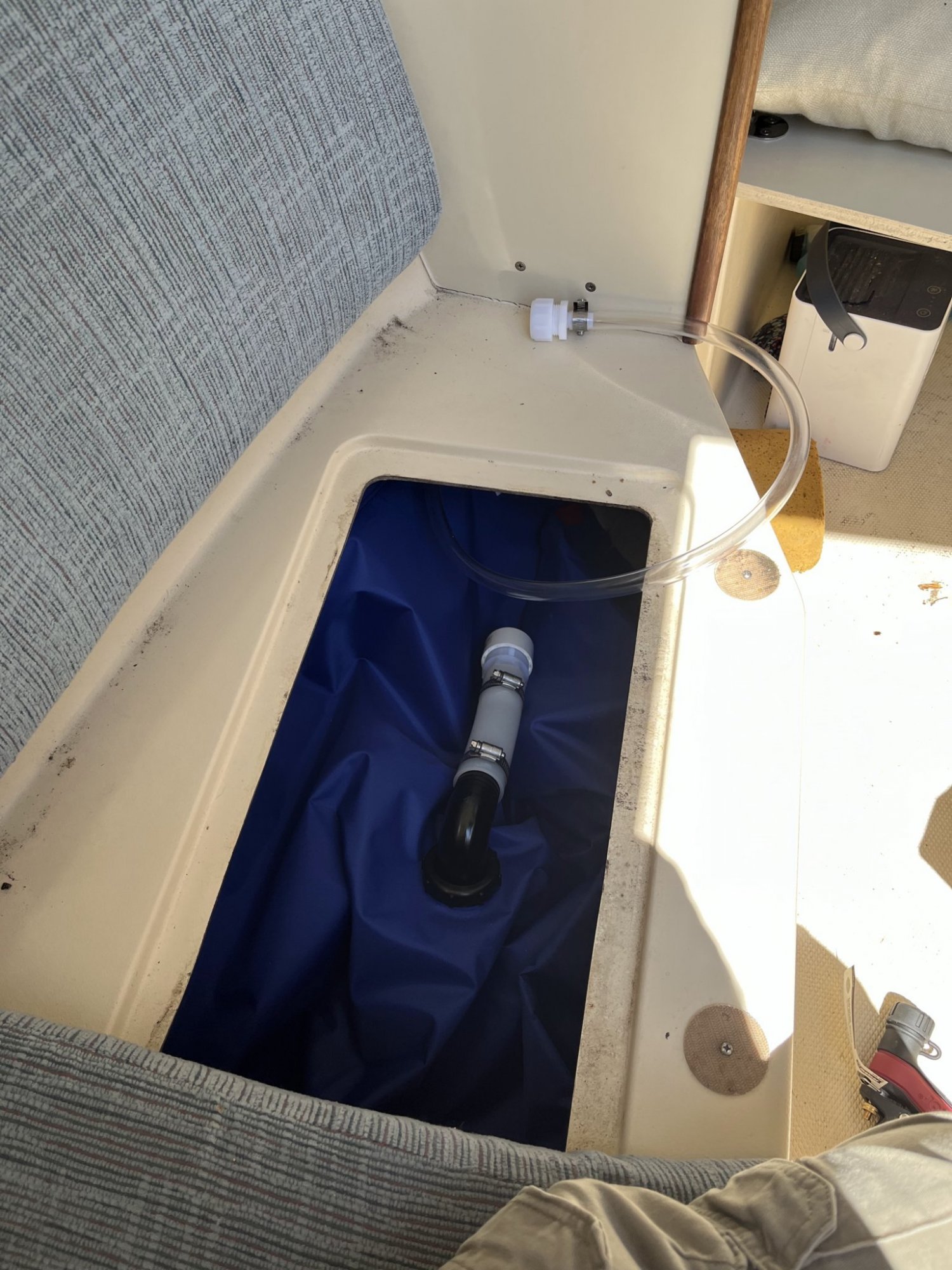

This afternoon the 1-3/8" I.D tubing came from McMastrer-Carr (neither Home Depot or Lowes had it). I went to the Wet Dog and installed the flexable tank under the Port seat in the cabin. I laid it in with the filler hole up and added water with a hose from the dock. It took a long time but it filled to capacity. I caped off the fitting using teflon tape. I put the plywood cover on the opening and replaced the cushions. I did not do the Starboard side as I was alone and the refrigerator on the seat is heavy. From looking at the boat from the bow it is slighting listing to port. I will do the other side tomorrow. I am looking forward to taking her out.
Plastimo 26 Gal Tank with filler fitting installed.jpgPlastimo 26 Gal under port cabin seat before filling.jpgPlastimo 26 gal with water.jpg

I added the Starboard flexible tank under the seat. I remembered that Elaine had fallen in the cabin and caught herself on the table. It pulled the top two machine screws out of the fiberglass. Drilled out all six hole and replaced the screws with machine screws with fender washers with nyloc nuts. I did not want the flexible tank to rub against the screw ends, so I did not yet fill the tank all the way. I am looking for a five by seven inch rubber sheet to cover the back of the table mount under the seat. I will post all this information in the modification section of the H240 owners page. I can tell that she is setting lower in the water by the way the gunnels lay up against the fenders on the dock. Time will tell if the tanks hold up.

I procured a kitchen silicone dish drying pad to place between the flexible water tank and the exposed bolt heads from the table mounting bracket. I doubled it up. I filled the tank with water and now the boat is balanced with about 216 pounds of additional ballast on each side of the cabin. She sits lower in the water as the gunnels are rubbing lower on the fenders attached to the dock. It looks like 9 mph winds and 76 degrees tomorrow on the lake. I will do a shake down if I can find a crew.

So far the I am pleased the the boat performance. I found that the starboard tank had leaked about three fourths of the water into the bilge. It was no issue for the pump and I now have the cleanest bilge of any boat on the dock. I pulled that tank and checked for leaks. I turned out to be an O ring issue on the bottom connector. I do wish the tanks had come with caps to close the openings. After two tries I got a good seal and put the tank back under the seat. Tuesday, Jessie and I sailed from Aqualand Marina at Lake Lanier to Port Royal across the lake ( about two miles). The trip was uneventful in 12 mph winds. We had a late lunch at Pelican Pete's. Heading back on to the lake we found that the winds had picked up. We did not bother to reef but did pull the end of the boom all the way up with the topping lift so that the main would spill her wind. We were able to maintain a heading close hauled at about 20 degrees heal. Gusts would take her to 30 but pointing into the wind brought her back up. Coming about was a none event; back winding the jib pulled the bow right around. The week before Shawn and I were out in 18 mph winds with the main reefed but without the jib. We could not come about and had to jibe to change course. Mother's day we are going out with six of us but winds will only be about 4 mph. If I went back in time I would do the ballast tanks again. The bow of the boat wants to stay in the water and she has a good heavy feel to her.
