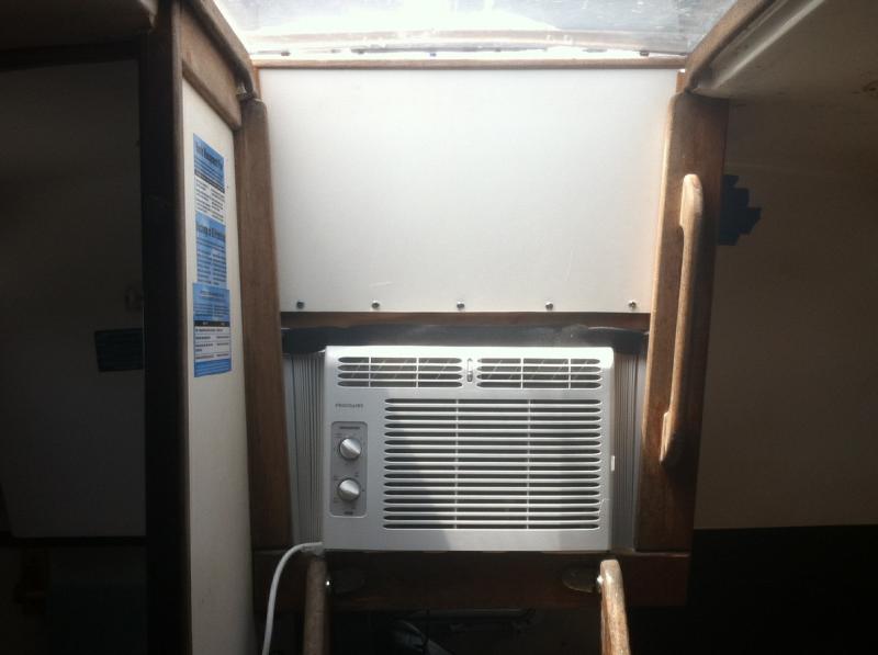

We added this unit this year: Frigidaire 5000-BTU Window Air Conditioner. Bought it from Lowes for 109.00 and installed where the lower hatch board was It fitl nicely out of the box due to the way I rebuilt the hatch boards. Cools the cabin nicely and stores easily in the the dock box when out sailing.
Do you have any problem with condensation leaking out of the unit and into the cabin or cockpit?
Have used a window unit in the companion way. The small threshold at the exit tilts the a/c unit slightly backward and the condensation runs on the outside. The small 5,000 btu unit fits well. The only problem is stepping over it to enter or leave the boat. While this is a good occasional solution, long term it may not work.
