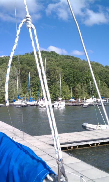

Currently I have a pigtail off the back stay - works fine but it does not allow the boom to swing and therefore must be manually attached/deattached whenever the halyard is released. Also due to the 'no swing' part if the boat turns while I'm forward messing with the sail it catches wind, and well, you know, things go downhill from there.

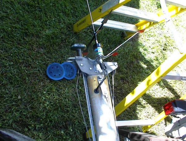

So a topping lift seems pretty easy, just run a line inside the back stay to the top of the mast. Well my masthead is currently 24 feet off the water so all I've got to go on is a photo to figue out how to attach a block to it.
It looks like maybe I could attach near the masthead/mast junction and hang a block to clear the back stay and halyards - I guess it could be a small block and 1/4" line.

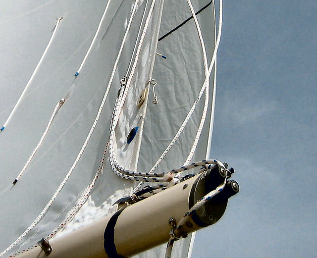

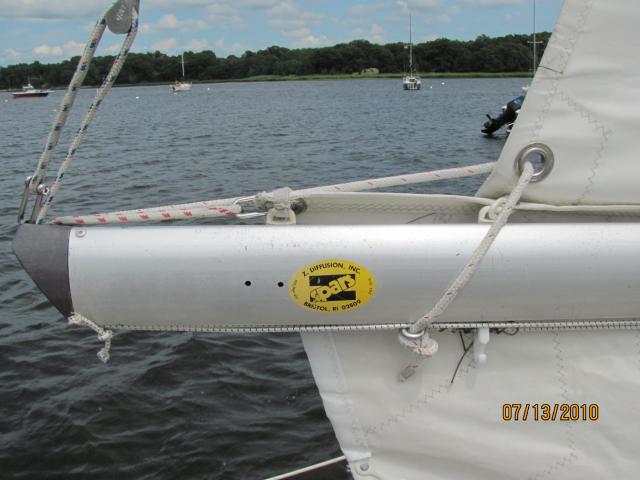

I like my topping lift set up because I can control the topping lift at the goose neck. My boom has internal control lines. The middle line is for the out haul, the Port line is for the Jiffy reefing, and the Starboard line if for the topping lift. My topping lift is dead ended at the mast head just inside of the back stay deadend, and the topping lift consists of a vinyl covered metal cable that comes down within about 12" from the end of the boom. It has a swadged marine eye fitting at the end with a small single sheave attached to it. The control line for the topping lift exits through a small built in sheave at the end of my boom and passes through the sheave at the end of the topping lift and deadends at the end of my boom.
You could have the same setup with the boom control line on the outside of your boom. The advantage is; you can do all your reefing right at the mast without going aft to adjust your topping lift.
The disadvantage of this set up; If the topping lift control is set with too much slack in it, it can wear on the leach of the Main and the sheave can bang against the boom while you're sailing.
