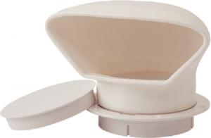

You can get a passive vent here:
https://shop.sailboatowners.com/prod.php?4917
with stainless cover if needed.

Solar vents vary in both price & quality. High price does not always mean high quality nor long life.
It is best to have both a solar vent & a scoop vent, for use in different conditions. Unfortunately, these vents don't all use the same size hole, so you either need to find 2 that match, or else have an adapter fabricated by some guy with a lathe.
My solar vent is cut right into my hatch. The down side to this location is that it blocks sunlight from getting into the cabin during the day.
In rough seas, I replace the vent with a water-tight plug.
