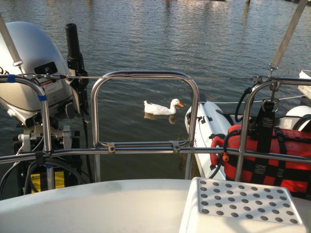

6 hrs at 5 knots from 3 gallons?
You must have a pretty efficient outboard, my Honda 9.9 burns about .8 gallons an hour at 5 knots. But it's pushing an estimated 8k pounds and I have a very low pitch prop. Anyway, I don't have a dedicated fuel lazarette, and I wanted more range so I decided to free up cockpit space by hanging a 6 gallon tank on the stern railing. I made a harness for the tank with rings, it clips on to the rail and it has worked well. I can remove the tank in less than a minute to take to the gas station for a fill up. Checking the fuel level is simple, I just turn around... No problems in rough weather either.
You can see part of the tank on the right side of the picture.
