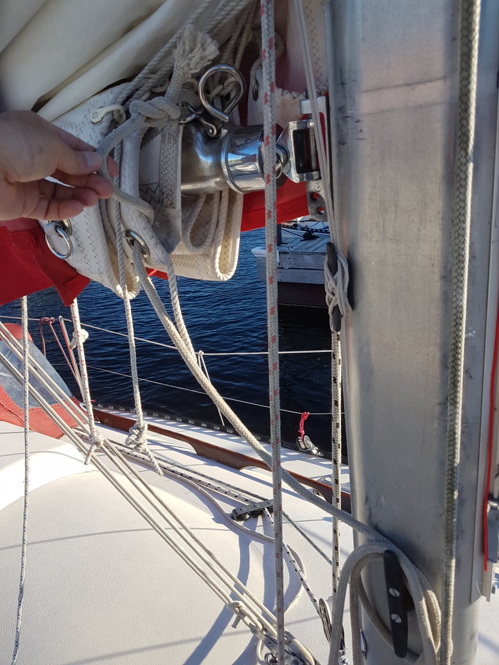

Here is my simple setup. The Cunningham is the line in my hand, fastened to the tack attachment, up through the crinkle, then down to a cleat on the mast.
