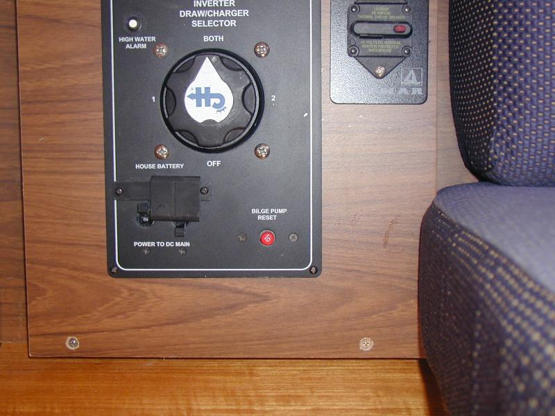

I think that what you may need is to run the #4 gauge (+) wire to the battery switch and use a Blue Sea Systems ANL fuse block with a 60A fuse. The negative
(-) wire can go to the ground post. For added convenience you could add a small On/Off battery switch in the (+) wire. That would be a rather large circuit to try to add to your main DC panel. Check the main breaker capacity in the panel as it is likely that it would not be adequate. I guess the highly amplified boom boxes are now finding their way into sailboats.
Feb 6, 1998
11,716
Most amps would get direct wired to the "switched" DC bus with a fuse or breaker. Turn on/off of the amp is controlled via the stereo's remote turn on wire. A simple toggle switch in this lead will kill the amp when you need to though some stereo's offer a setting to turn off the amp or sub depending upon which remote turn on lead you use..
