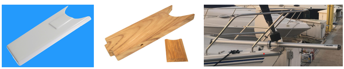

You'll pay $330 for an 18 inch piece of teak, or $600 for the same piece in fiberglass, plus another 5 or 6 hundred for hardware. Oh, and a new, slightly longer headstay would probably be needed. Well over $1100. Installation shouldn't be too difficult.
However, since you're doing this strictly for racing I'd go with the more modern, retractable tube style sprits like those offered by Selden. I think they're cool, plus cost is almost half the traditional version, and much, much easier to install. May save you a few bucks on slip fees too because marinas measure the whole boat.
That seems a pretty good summary, but note the OP is looking to move the CE forward and he wont be able to do that with a sprit.
My advice would be to consider buying a #2 genoa to solve the balance issue in the upper teens and then go with the sprit to add a upsized asymetric.

Like Sailfanatic said, using a #2 rather than a #1 would move the Center of Effort forward, but at the cost of total E. However, you can move the CE forward, and even slightly increase Effort by moving the entire jib forward with the bow sprit setup used on a tall mast boat.
So the fixed sprit shown in SFBay's post is what I was thinking.
