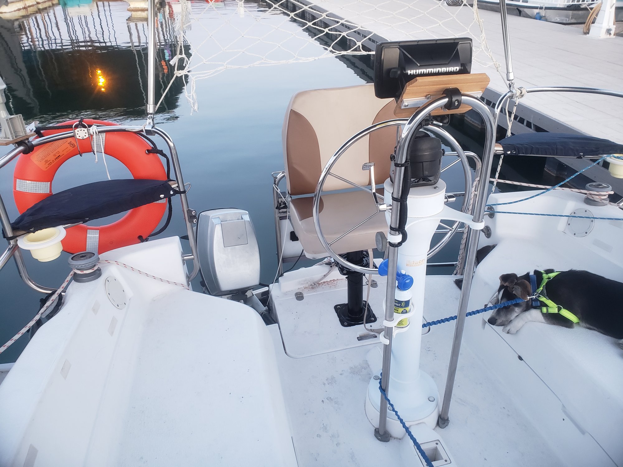

Most or all H26's came with a tiller. Someone added a wheel to mine but there was no place to sit. I found a nice seat on craigslist, bought a couple of mounting brackets and drilled me some holes
It is a world of difference from standing up all the time.

I don't have the original paperwork or history of this boat.
The steering works via two heavy cables that run from the wheel mechanism to a kind of quarter wheel connected to the rudder.

It makes a world of difference. Standing with the back rail at around knee-height and no backstay to lean on I never felt very stable before.

That looks awesome. Question..... do you have to remove the seat to lift the gas can locker? It would be mighty nice to have a wheel instead of a tiller.

The seat is removed with a pin so I can access the gas locker below. The puppy leash was suggested by someone on this forum and works great.
