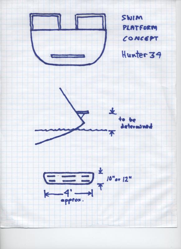

Good morning.
Attached is a very rough sketch of my concept. Maybe, as I envision the platform being something like 4' wide and 10" to 12" deep, it is more like a big step. I don't want it protruding out too far, thus the narrow idea.
Dave

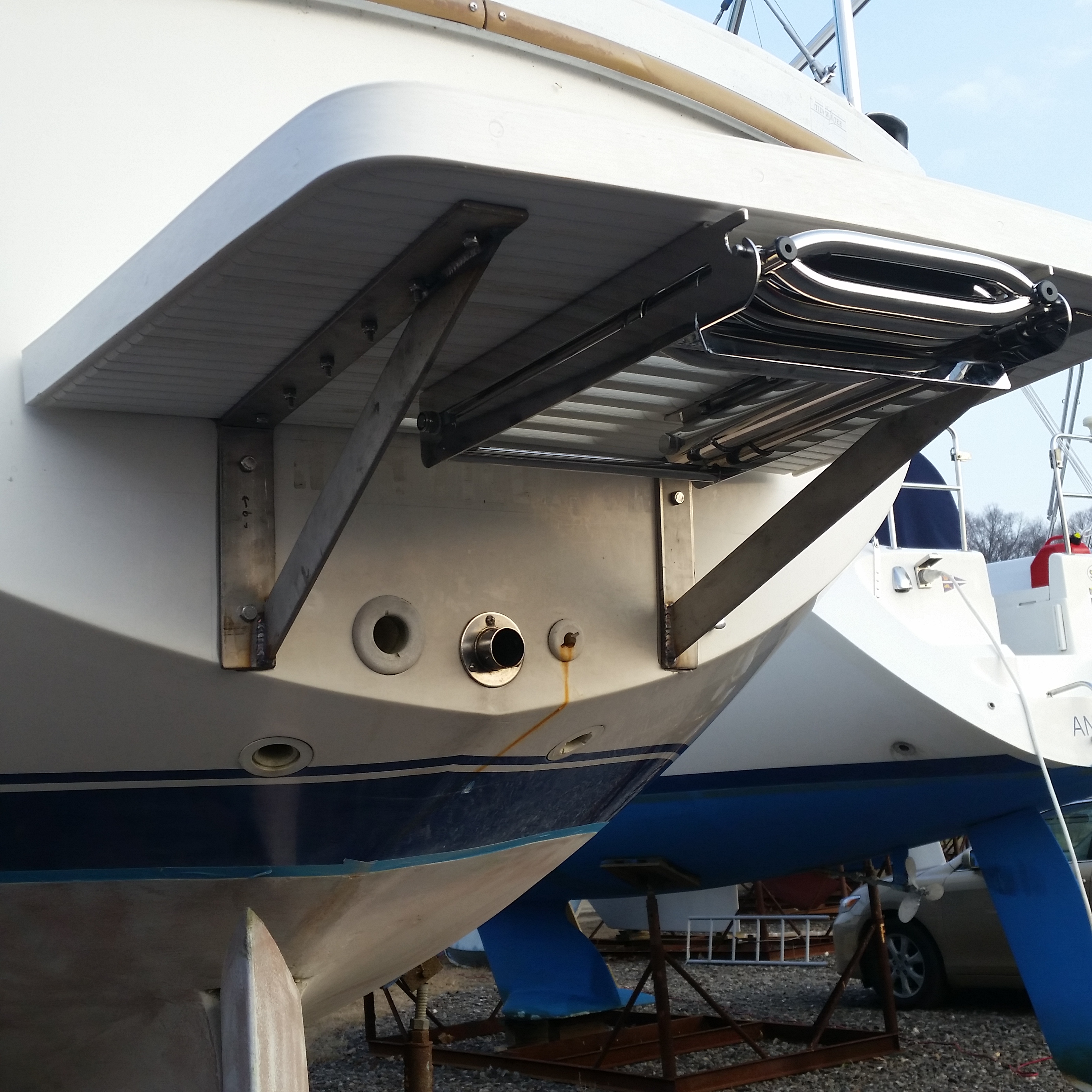

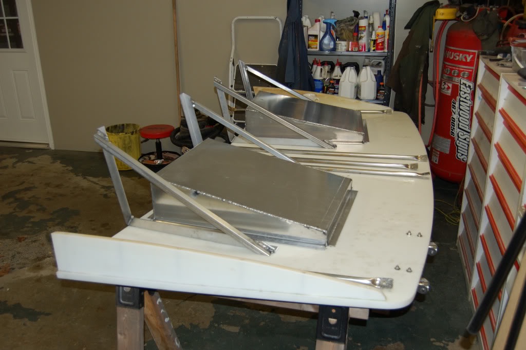

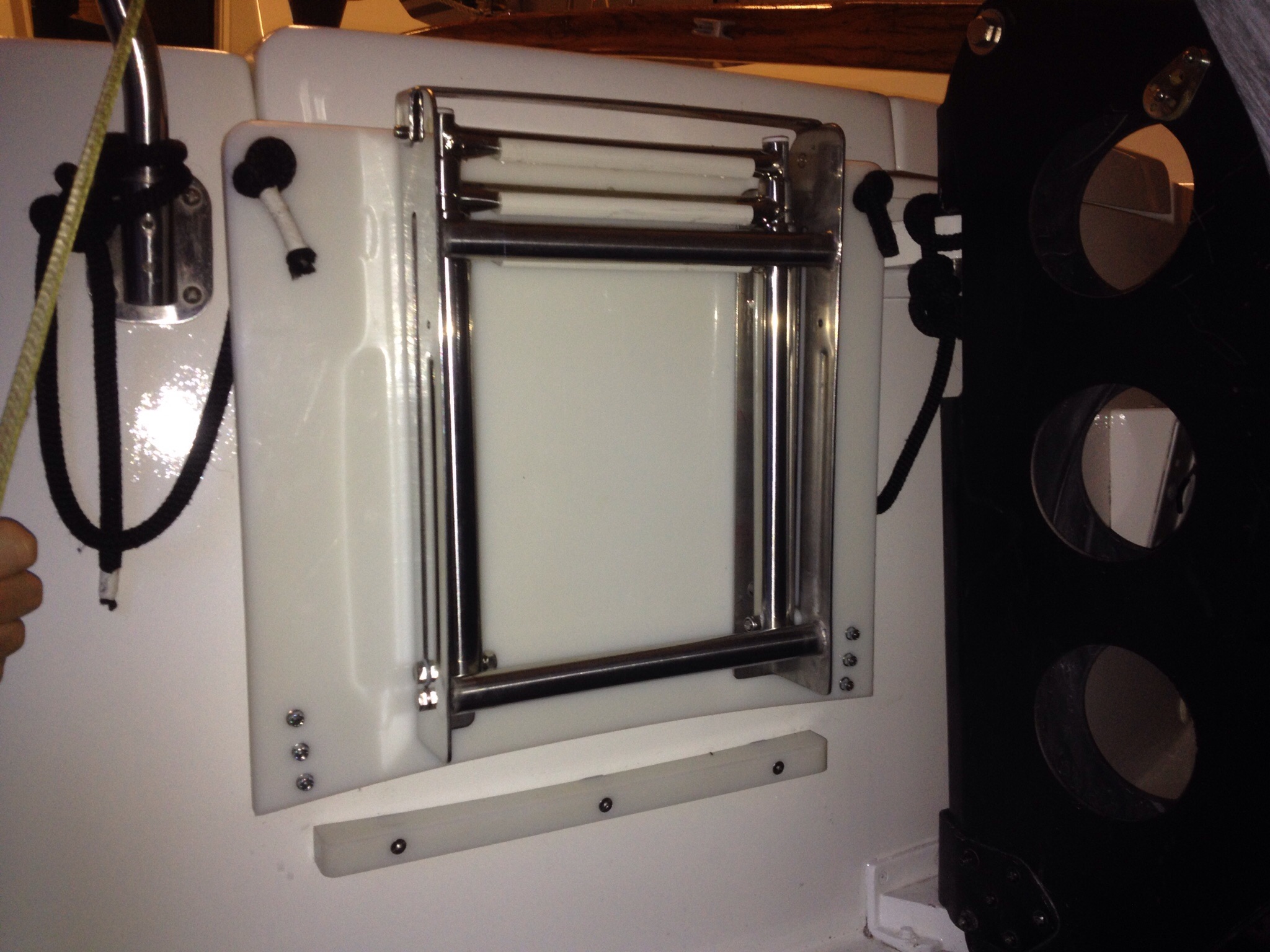

Here is the one I added to my Catalina 30. I am very happy with it and it does several jobs. A easy on off platform . A quiet back porch for a drink to watch sunsets or sunrise. It makes getting in and out of the dingy much easier. It is really nice when you have to hang the motor on the back of the dingy. It will work as a way to carry the dingy from place to place.
23,784
You must have placed some stout backing plated on the inside of your transom to manage the weight. Any issues with a following sea? Like the idea especially the boarding ladder, wonder if a folding platform could work?

Sep 25, 2015
60
Catalina 30 Middle River
Yes it has a 1/4 stainless steel backing plates on the inside of the transom and It appears to be plenty strong as the Transom and the rear section of the lazarett is tied together with plywood that hold the propane tank storage. I had a Mechanical engineer approve it. (My Son). I have no concerns with it in a following sea it sits a foot or move above the water. my exhaust never goes under in a following sea I don't think this will. It could fold but I will use this to carry my dingy at times so it would then have to be supported from above instead of below. There has been much thought into this platform. It make getting in and out of the boat so much easier.

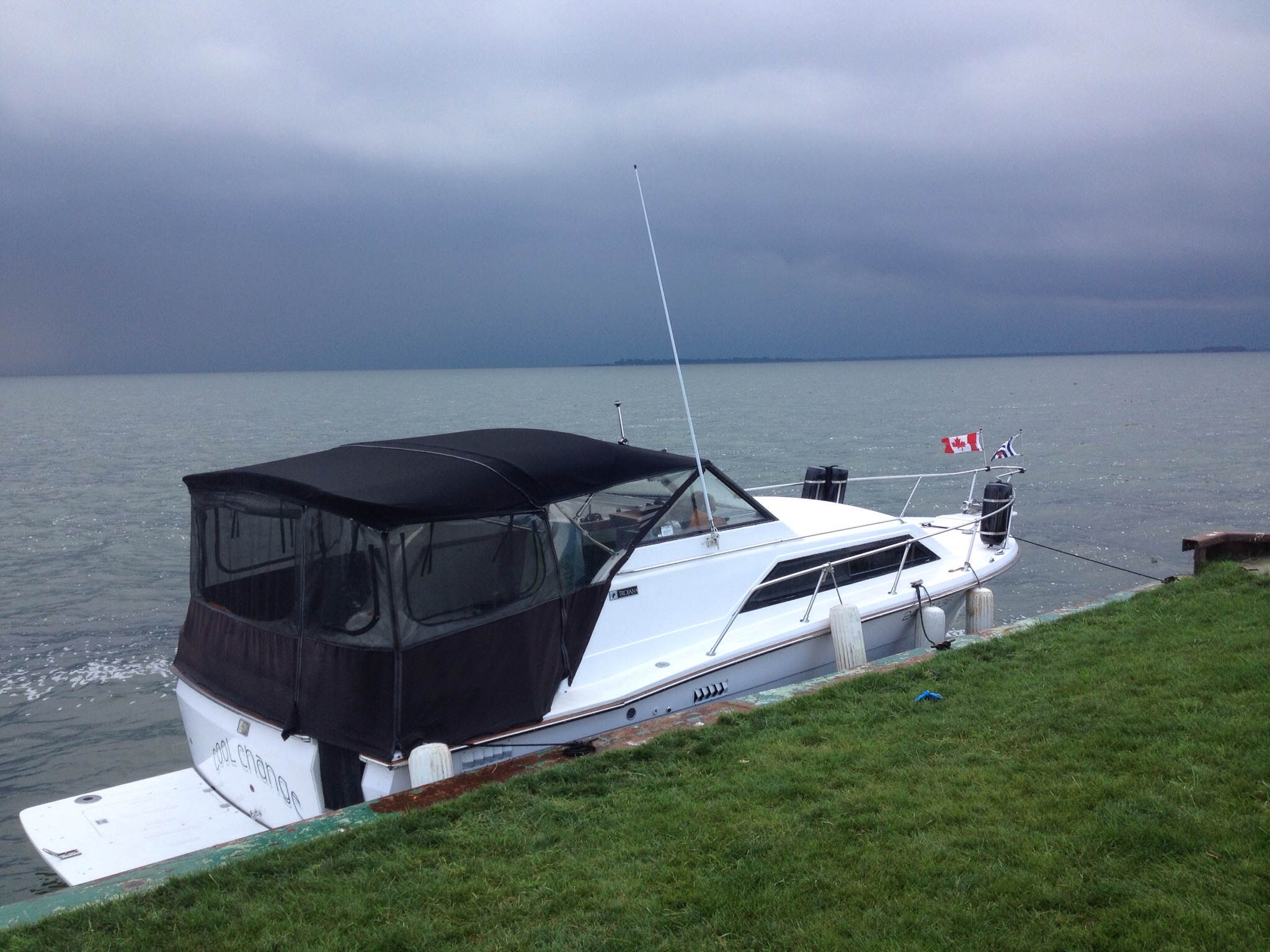

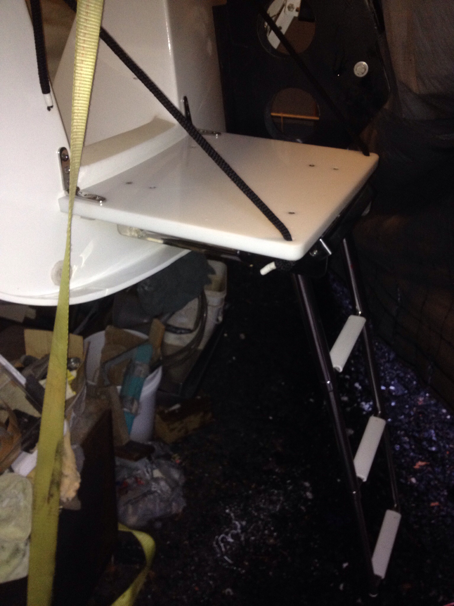

Yes...
Ignore the hanging ropes....was still installing it at this point.
Did it to my cabin cruiser as well...
