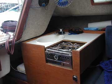

We have a 1986 Hunter 23 with no galley. I could probably build one if I had plans. Can anyone tell me where I can find plans or where I can buy a galley? Thanks!
Kermit
Jul 31, 2010
5,687
Right. It does not have a galley at all. Wonderful cockpit and cabin. Just no galley. We put the alcohol burner on the step between the cockpit and cabin. Then we wash dishes on the seat in the cockpit. Wife wants a place for the stove and a sink. The paper towel holder in your picture looks handy, too. Any ideas how to build a galley or buy one?

There are a lot of H23s for sale. I think that with enough pictures you could design and build one. Yacht World and Sailing Texas for example. Maybe you can find another H23 owner in the area that has one. Check the Owner Directory, top of the page. Here's another picture. Pretty simple, looks to be designed to slide back.

Does your 23 have the slots at the edge of settee and at the shelf where a galley used to be??? The galley is just a plywood box and therefore are not hard to make. I just don't know if they are interchangable between years. Mine is an '89 and looks just like Ed's .

Sure I will take some dimensions. It will be this weekend so give me a way to alert you that I have indeed followed through. There is plenty of opportunity to build your dream galley in the space available. I like the fact that it rolls out for use. And there is a little room to store food in a flat box underneath. The big waste is the area below the bunk that has no access hatch. I'm thinking of how to use it..... got any ideas???

That looks like a slider unit for when not in use, perhaps it can be pushed back under the cockpit seat to provide better space utilization.

I have a '91 H23, and my battery is located in the lazarette, behind the bulkhead. The sliding "galley" unit (the box that houses the sink and alcohol burner) is in front of the bulkhead. Your boat may have the battery under the bunk area that is covered by the galley when it is stowed (slid rearward under the cockpit, up against the bulkhead), though I don't see how you'd service it if so. And if you build it the same way as the factory, the galley will be removable - the vertical face sits on the outer edge of the bunk, and the horizontal surface is supported by and slides along the port side shelf. You remove the companionway step to slide it forward (unstow it); that step locks it in place when stowed.

A sink, a pump faucet, and alcohol stove can be got at a West Marine, the rest is a plywood box
The layout on mine (88) is rotated from that picture, sink on right stove left.
