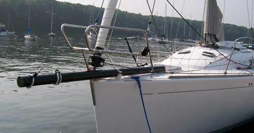

Forespar's Attempt
I think this is the second version I've seen Forespar produce; they had one online last year with a slightly different design. Now who'll be the first to say it looks home made?

Try this...
Here’s an easy-to-make bowsprit, seats in the anchor locker. This will throw the spin ahead of the main, less blanketing. Tack line and 2 sheets permanently deployed for quick setup. (Note that the link here has 2 pages of pix and directions.) Typo correction: Eyelet should be 3/8 inch. Hey, $50 tops.
