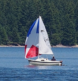

The "extension" you talk about is often a pole extended infant of the bow. Known as a Bow Sprit. I designed and built one for my Montgomery 15. Here she is on my first sail with this rig.
Because the sail was out in front of the forestay, I could make the sail bigger, and when I gybed it would flip out in front of the boat and come around on the new tack. Again complexity can get you in trouble. Not I ran the sail off the mast head by locating a block on the mast head. I made sure that the standing rigging was beefed up to handle the additional strain. The Montgomery rigging was very strong for a boat her size.

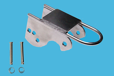

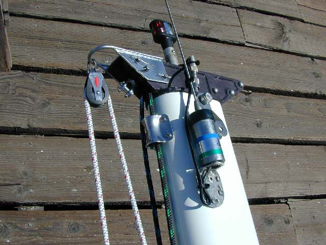

For starters you will need a block or sheave off the forward bit of the mast. Because a spinnaker is flown out in front of the boat and from the mast head ( most often) one needs to rig the halyard to be out the front of the mast. This is often accomplished by the use of a block attached to a crane ( a hoop of steel that is fixed to the mast top and stretch’s a few inches out in front of the mast).
Examples

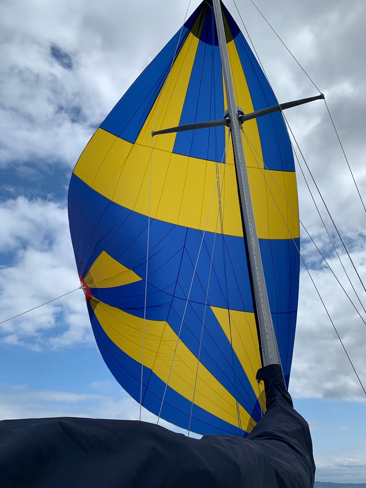

The picture in post #8 shows the Javelin with the spinnaker flying from upper mid mast. So I presume the Javelin is a fractional rig. Yes the spinnaker halyard has to exit the mast above the jib halyard. Running a halyard is fairly easy. If I have the rig right, you would need to install a exit box where you want the halyard to come out. A plumbers snake, or a piece of straight stainless wire will work to thread the line down from the mast exit block (This is done with the mast off the boat and on saw horses.) You will probably use an exit plate on the bottom of the mast (follow what was done with the jib). This would be high enough so you can pull down on it - but you can figure that part out. You can also run the halyard externally using a SS eye and a block. That would be much easier but it's not clean and looks sloppy.

Looking at image, I suspect the jib halyard was used to fly the spinnaker.
I know that is what I considered when designing a spinnaker rig on my Montgomery 15. Ultimately I decided on rigging the sail at the mast head. Used a mast hound to attach a block to the mast. Attached a block and ran the halyard. Had an asymmetrical sail built. Ran it from a bow sprit. Fairly easy to set up. Great sail in light breezes.

I suspect if the Javelin 14 hardware is in good shape, rigging using the jib halyard would be sensible. You don’t fly the jib and the spinnaker at the same time.

In the picture in reply #8 it's hard to tell if they have a separate halyard or not, but basically seems the simple choice is bring the jib down, secure it, move the jib halyard to the spinnaker, and hoist it that way. The other choice is before next season before I have the mast stepped (I keep it in the water out back not trailered), run a separate halyard for a spinnaker on the mast. Notwithstanding the neater look having it inside, I'm probably more inclined to have it outside - seems easier to do. Yes, I've got one block just above the block for the jib halyard about 1/3 of the way down the mast, and then a second about in the middle of the mast between the spreaders. So presumably if you do you run a separate halyard for the spinnaker, you keep the end that would attach to the sail clipped to the mast, and the other end... where? Do you need a new cleat on the deck by the mast?

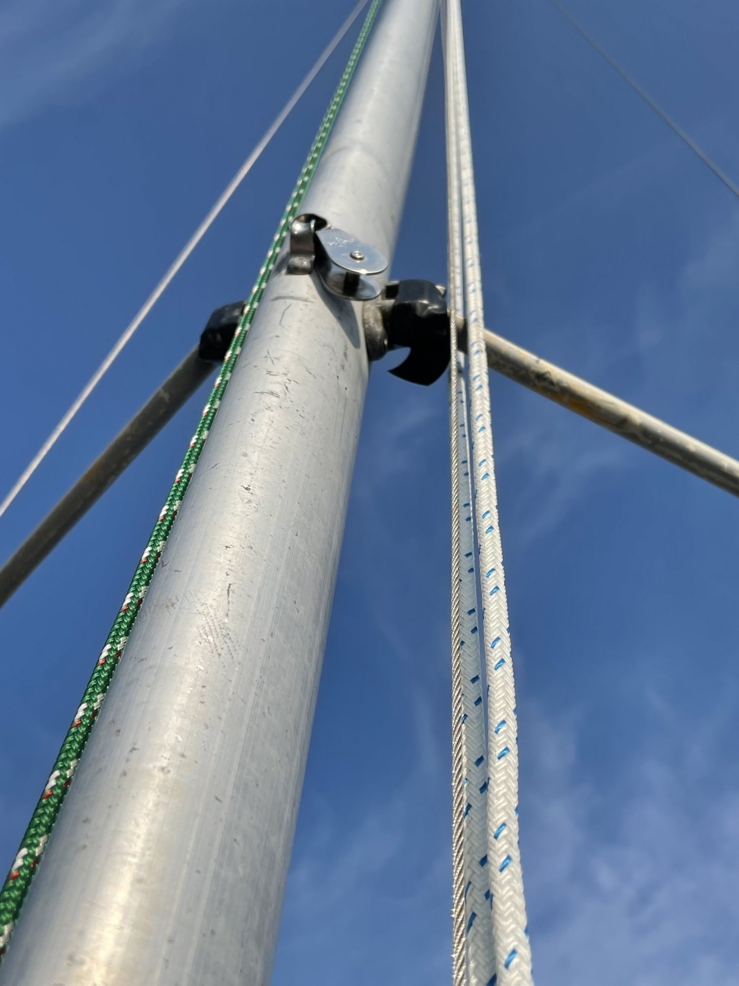

Your image
Shows a block. It appears the sheave is missing from the block. Some low cost blocks used a white plastic sheave (the wheel in the block that the line runs on). The plastic breaks down over time leaving a block with a metal bar in the middle. You can run line (or halyard wire) over the bar, but there will be a lot of friction and the line will start to break down because of the tight bend.
If the block has a screw holding the sheave pin then you might find a replacement sheave. More likely you’ll just buy a replacement block.

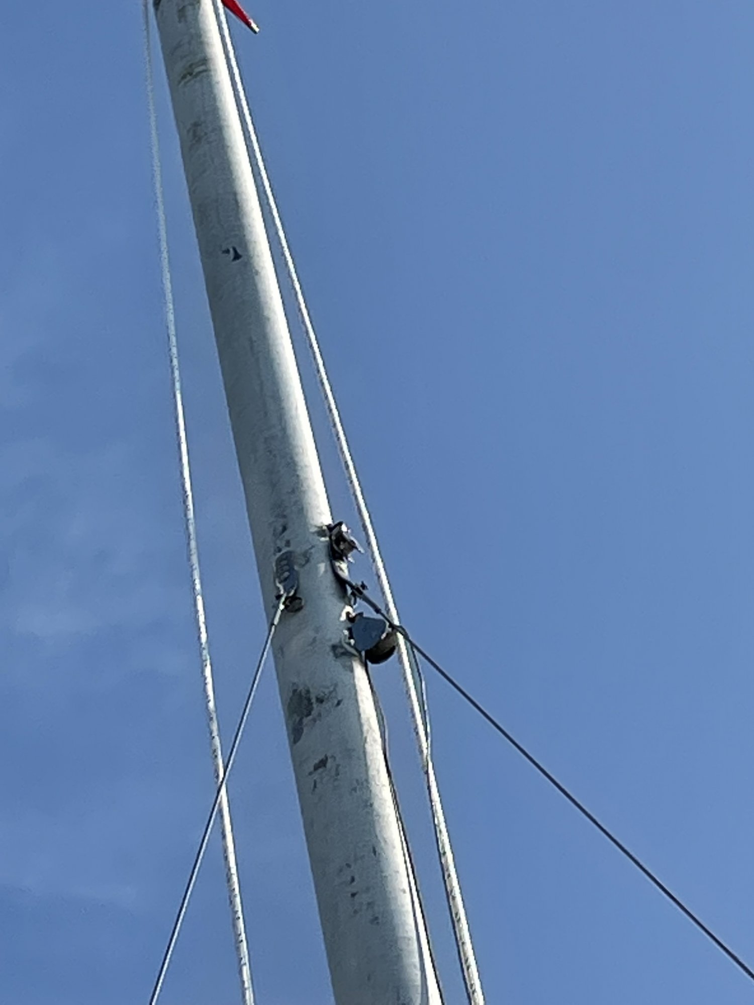

the second image
Has two blocks. The lower one designed to work with the jib. The upper one (when repaired) will work as the spinnaker halyard.
May 18, 2021
36
O'Day Javelin Barnegat Bay, LBI
Thanks very much jssailem. Indeed, the lower block in the second picture is where my jib halyard runs. The upper one for spinnaker. Then what's the block between the spreaders... that's a mystery. Not exactly clear from the javelin owners manual/rigging instructions.
23,610
Philly. That one looks to be missing the sheave as well. You could use it as the up haul to hold your spinnaker pole up. You might also add a down haul for the pole to adjust for your spinnaker.
