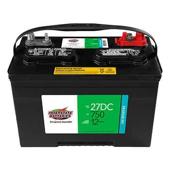

Would these be a good choice? They are $95 a piece with core:
Doesn’t look like a great choice. Generally speaking anything rated in CCA or reserve capacity is not a deep cycle battery. Like Dave said, find a couple new true deep cycle batteries and they’ll provide more than enough starting current for a small diesel.
Carrying around a starting battery that doesn’t support deep cycle use is, IMHO, not a great use of weight for a sailboat.

Davidasailor26 "anything rated in CCA or reserve capacity is not a deep cycle battery. "
I don't know. How do I tell if it is a true deep cycle? I thought the DC stood for deep cycle. I would have thought Interstate was a good battery. Thx
David, if this will be your dedicated starting battery this is fine. I use a basic auto battery as my dedicated starter on my c34. My house consist of 4, 6 volt golf cart batteries. Your needs for house may be way different.

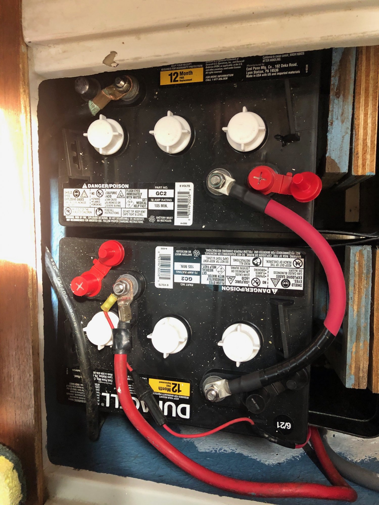

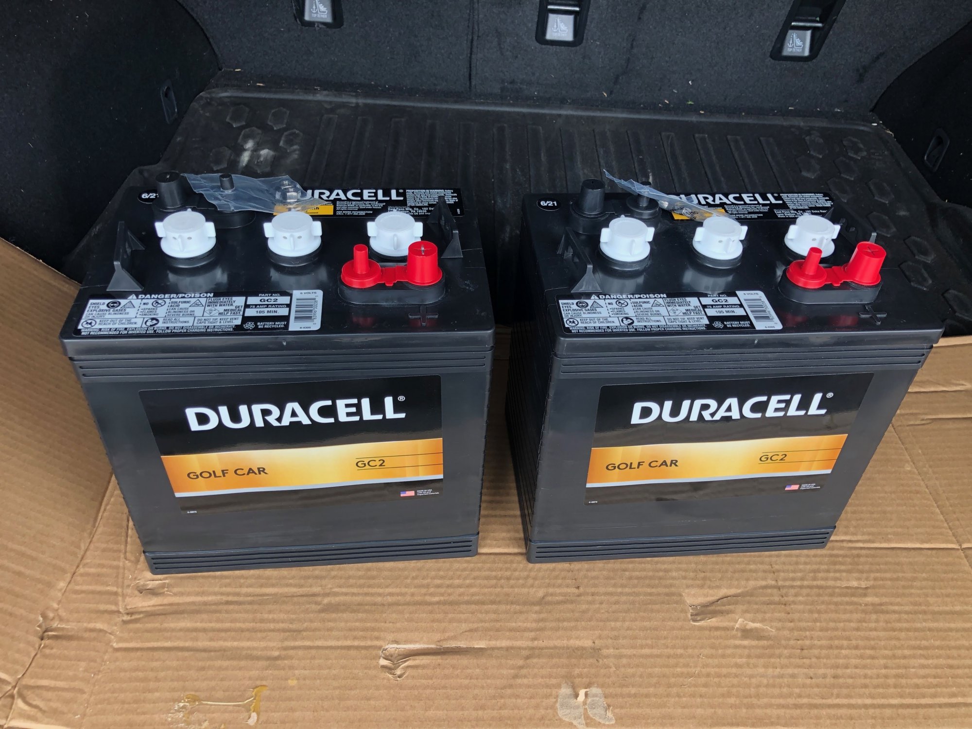

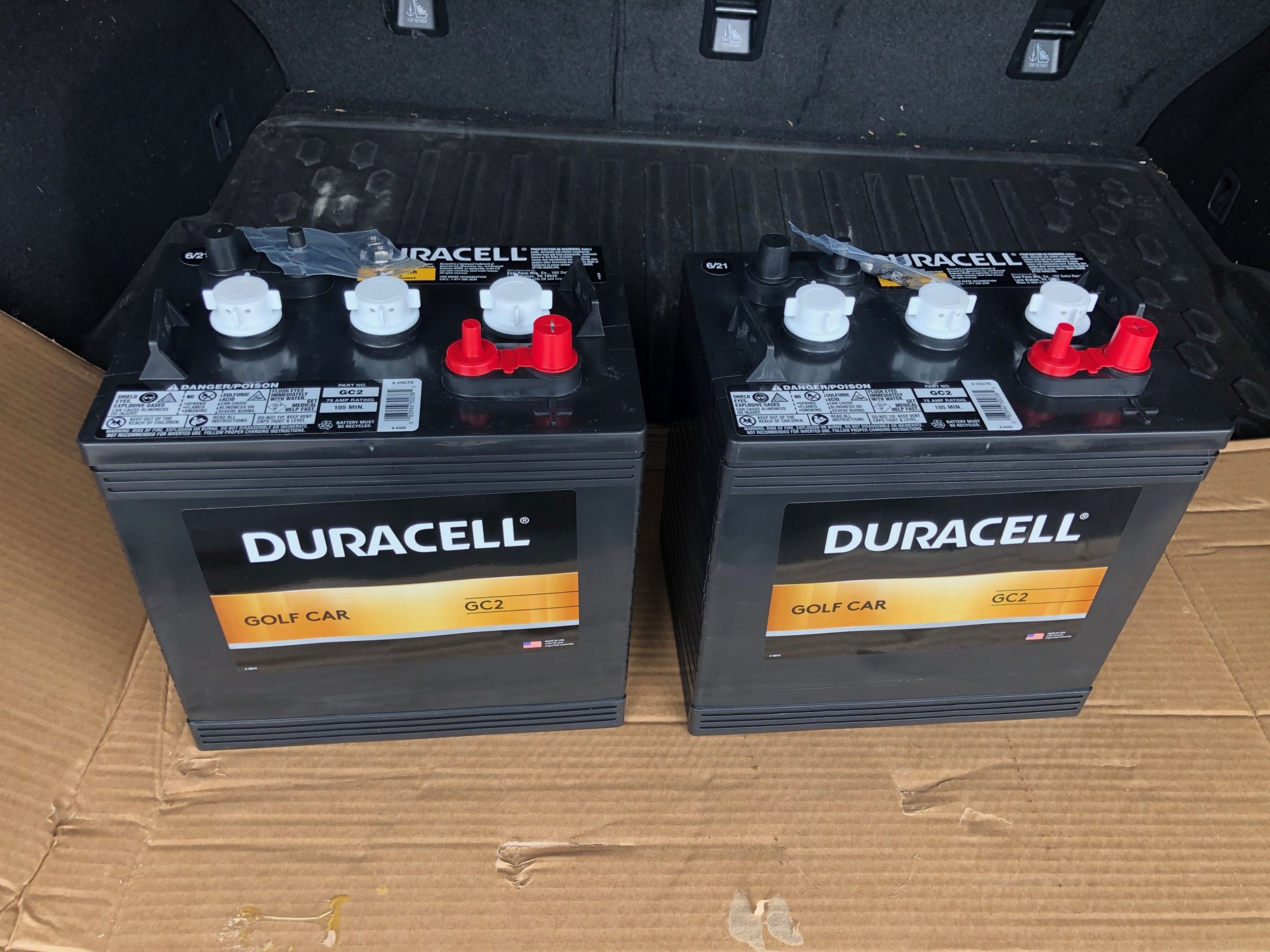

For starting the engine only, you can use the one you indicated. It would not be a good choice for a house bank. I like 6-volt Golf cart batteries wired in series to get 12 volts. Those are designed for heavy draw downs.
I have used Group 27 “deep cycle” batteries for starting and for my house bank in the past. Deep cycle marine batteries should show Amp Hours of capacity at a certain draw rate. My 6-volt batteries are 215 AH capacity for example. But for starting battery, almost anything should do. You aren’t drawing it down very long.
You really don’t “need” a starting battery either…they are extra insurance and they can keep your instruments from “browning out” when you start the engine and it drops voltage to the instruments. So a separate starting battery is a nice to have item.
But I don’t have one on my O’Day 322. I put 2 GC batteries in for a house bank, and use it t start the engine too.
No issues the first season with them.
DC means Direct Current.
Dave, are you serious? I was marveling at all of the bad information in this thread, and was shocked to see your comment. Now, if you can find me an AC battery, one that produces alternating current, you will really get my attention!
Interstate and others have adopted this supposed size, 27DC, to mean group 27, deep cycle, although that designation doesn't exist in the BCI spec.
That said, you buy deep cycle batteries by weight. :). Most of the garden variety, supposed deep cycle batteries, Interstate included, are junk.
