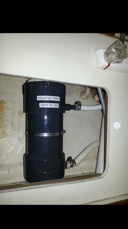

In my previous life I served on Fast Attack submarines. Our sanitary tanks were blown to sea with high pressure air. We then had to vent the tank back to atmospheric pressure and because venting overboard would release a trail of bubbles possibly allowing the boat to be detected by an enemy, the tanks were vented inboard through an activated charcoal filter. It didn't really do much to eliminate the odor.
Dec 19, 2006
5,832
Hunter 36 Punta Gorda
Vent Filter
I got got tired of trying different ways of controling the odor when some one flushed and the holding tank odor would come out the vent and into the cockpit.
So since 2007 I have had to buy my second vent filter from Defender and guess
what no odor at all coming out the vent and all are very happy,I use gallon jug from WM and mix another jug of it with water and use fresh water flushing and pour my mix of holding tank chemical every few flushes and never any odor any place.
Vent filter $85.00 and I think I replaced the first with a second filter 1 or 2 years ago since 2007 and no orders.
