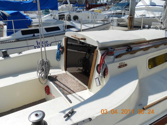

acrylic companionway door
May 29, 2010
3
Oday 25 dana point
Decided to modernize the door using 3/8 acrylic cut to size and edges polished then two layers of window tint, bronze with a limo tint overlay on the inside. Really easy to see out but difficult to see in. Total cost to purchase acrylic, have it cut and polished, and add tint, 150.00 Be sure to use a special drill bit for acrylics for hasp attachment...
