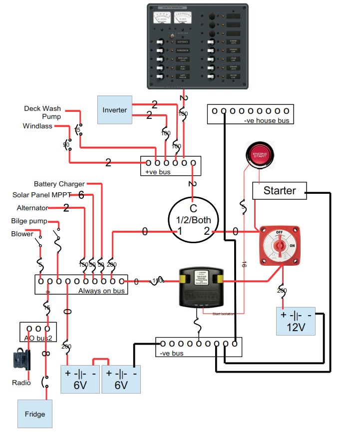

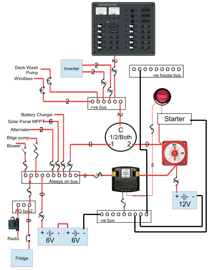

Hello. I’m redoing the mess of an electrical system starting with battery setup. I’d like to get an opinion on how I’ve laid this out, and any improvements or cautions are appreciated. My engin is a Beta Marine 60 with the starter/Alt coming from one output bolt. Thanks!
