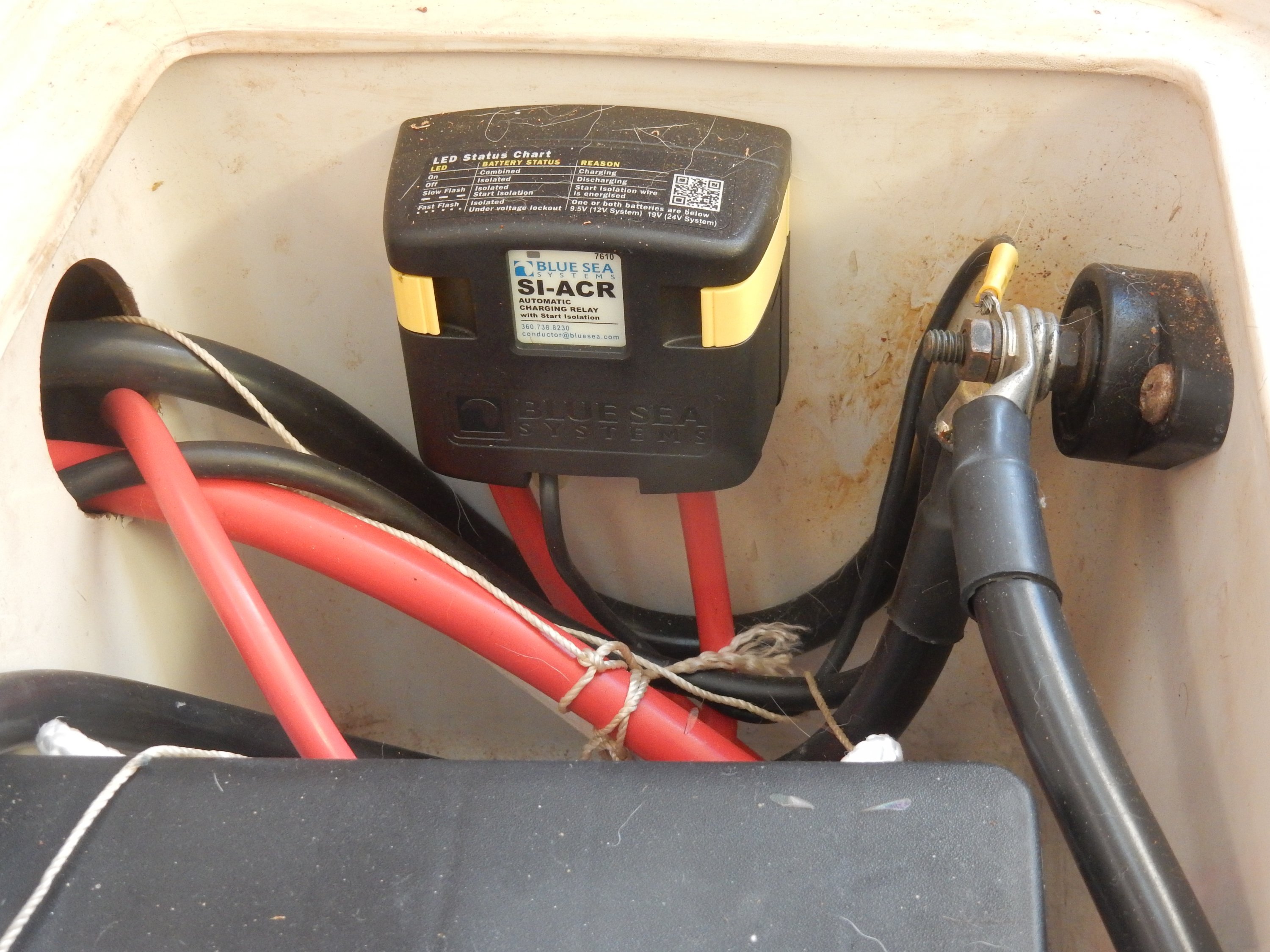

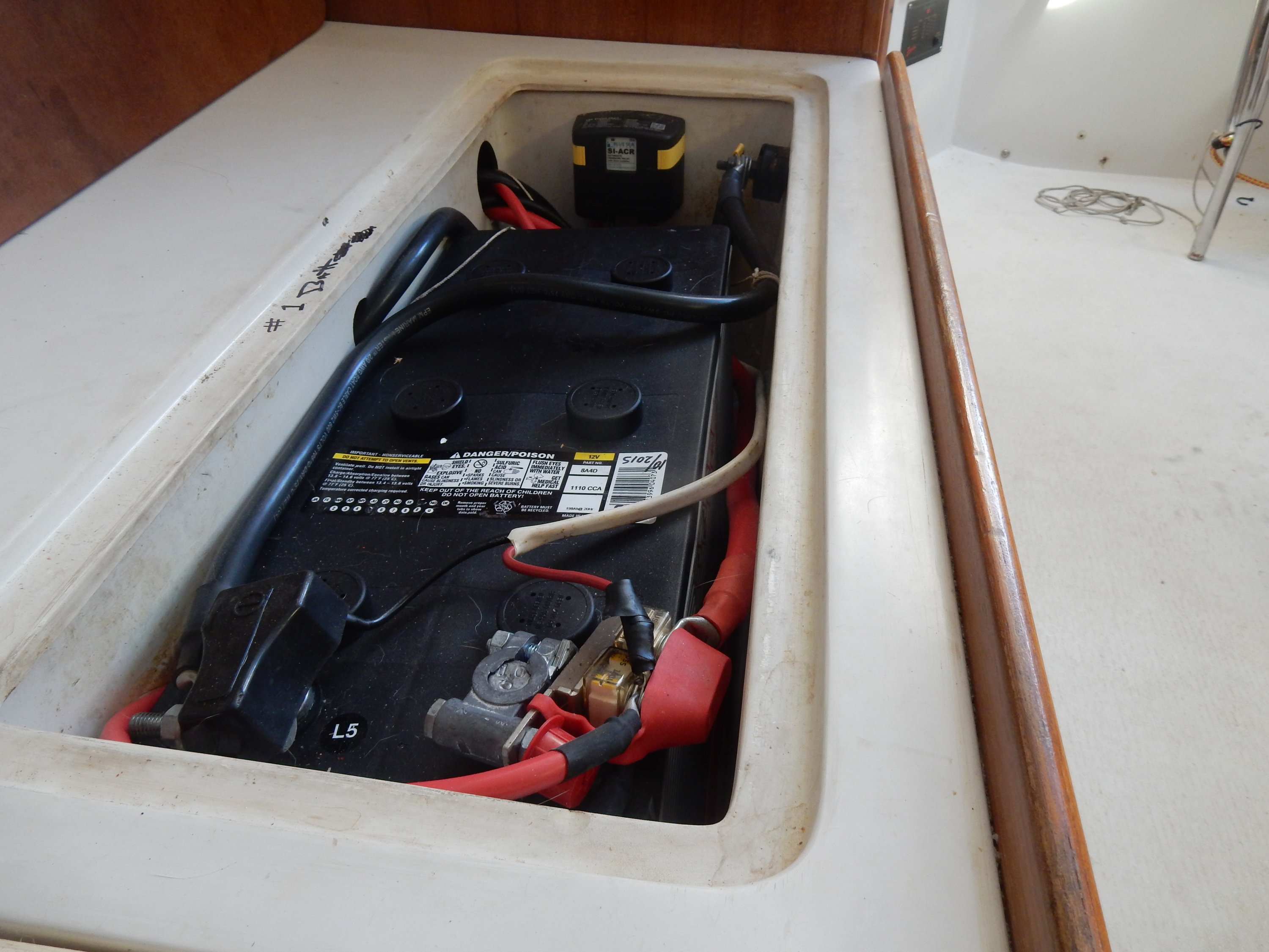

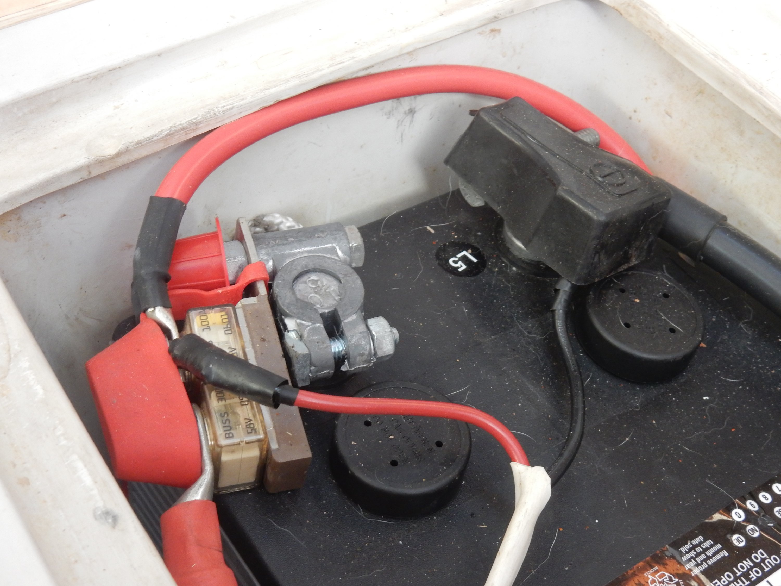

I have a 1995 Catalina 30 MK III and I mounted the ACR under the starboard settee with my 4D battery -Battery #1. (Battery #2 is located under the quarter berth next to the hot water tank.) I installed new cables to batteries, starter and alternator as shown in the attached diagram (Neg cables also 2/0 but not shown). Because of height restrictions in the battery compartment, I mounted the MRBF dual fuse blocks on the side of the battery terminal as shown in the pictures. (The smaller wires in the picture are from my battery charger, which also charges both batteries via the ACR.)
I purchased a remote indicator for the ACR but never installed it since I can easily check whether the unit is charging by using my battery check switch.
I did this wiring a few years ago and it works great! Engine starts quickly even if the battery voltage is less than 12 volts, after a night or 2 on the hook.
Regarding the cables, I purchased the cables from www.genuinedealz.com. They made up custom cables complete with terminals. Free shipping, quick delivery and no tax.
