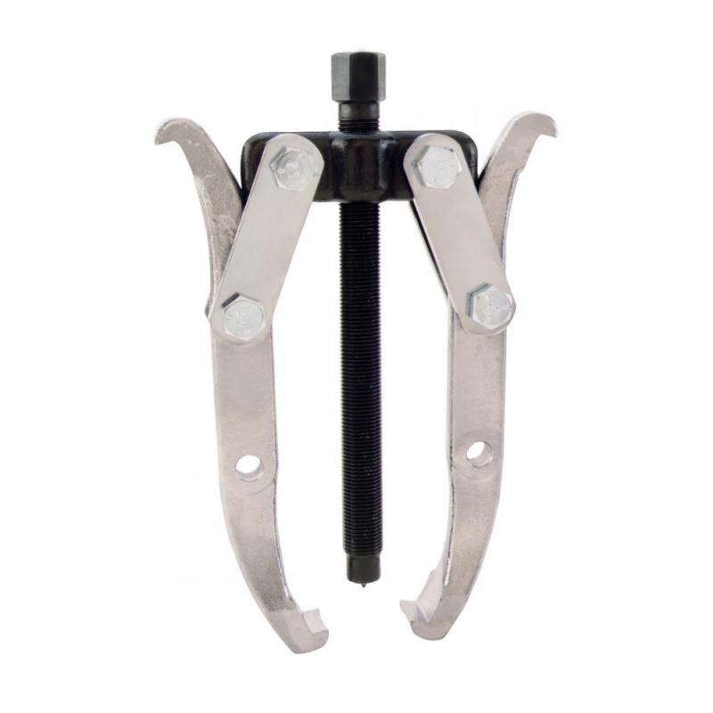

If you've gotta use a three jaw puller in a tight place, underwater etc., sometimes you can put your hands on a puller that has a couple of extra holes in the jaw part, (if that made any sense), and run shock cord through them basically holding the jaws inward. I feel your pain in this, as holding all three jaws on tightly, and then spinning the jack screw in until it contacts the shaft can be a new way to learn to scream profanities underwater. (I'll bet Fastbottoms can do it:D). If you go the route of the three jaw, make very sure that the jack screw has fine threads as opposed to 'faster' threads for the pulling power. The old trick of jacking the puller down tight smacking it with a hammer for the shock will not work underwater, and pounding on a boat shaft with a beater is sorta discouraged anyway, tranny problems, etc. I've never used that particular model of puller that was pictured, but from my experience it looks like a nice one, that I would probably order from the appearance.
By the way, I like OTC tools in this category, incredibly well built tooling, and I exclusively use their pullers, pry bars, things of that nature. I know of no finer tools built for this. Of course you can mortgage the farm and buy space-age, or high-tech tools, and even heavier tools for that matter. Bearing in mind it doesn't take a bulldozer to clean up the front yard, OTC is hands down my favorite in this mechanical category of tooling..

I just did a quick search for the OTC pullers, and this two-jaw pictured would be a waste of time unless you are pulling two bladed screws, but the holes in the jaws is what I was talking about running shock cording through them. It WILL help hold the jaws onto the work, even on dry land as well, where the atmosphere is such that the cursing can be heard all the way to the office and beyond..

I've checked out the Puller fstbttms recommended. I like it but price is kind of steep ~US$400 (incl shipping). :eek: Wifey would struggle me if she finds out. Guess I'll have to make do with what I have for now. I'm not into business of pulling prop. Just a weekend sailor playing around and ocassionally help a sailor friend or two with their boat maintenance. Just last weekend, I wrecked the heavy duty 3-Jaw Extractor (just like the pic from Chris) :doh:. The long tightening screw buckled and bent :confused:! It seems the prop is superglued to the shaft ! Now we turn the job over to a professional :redface:. Bless him.

PS: Chris, I was thinking along same line, tieing shock cords on the jaws to hold inplace.
