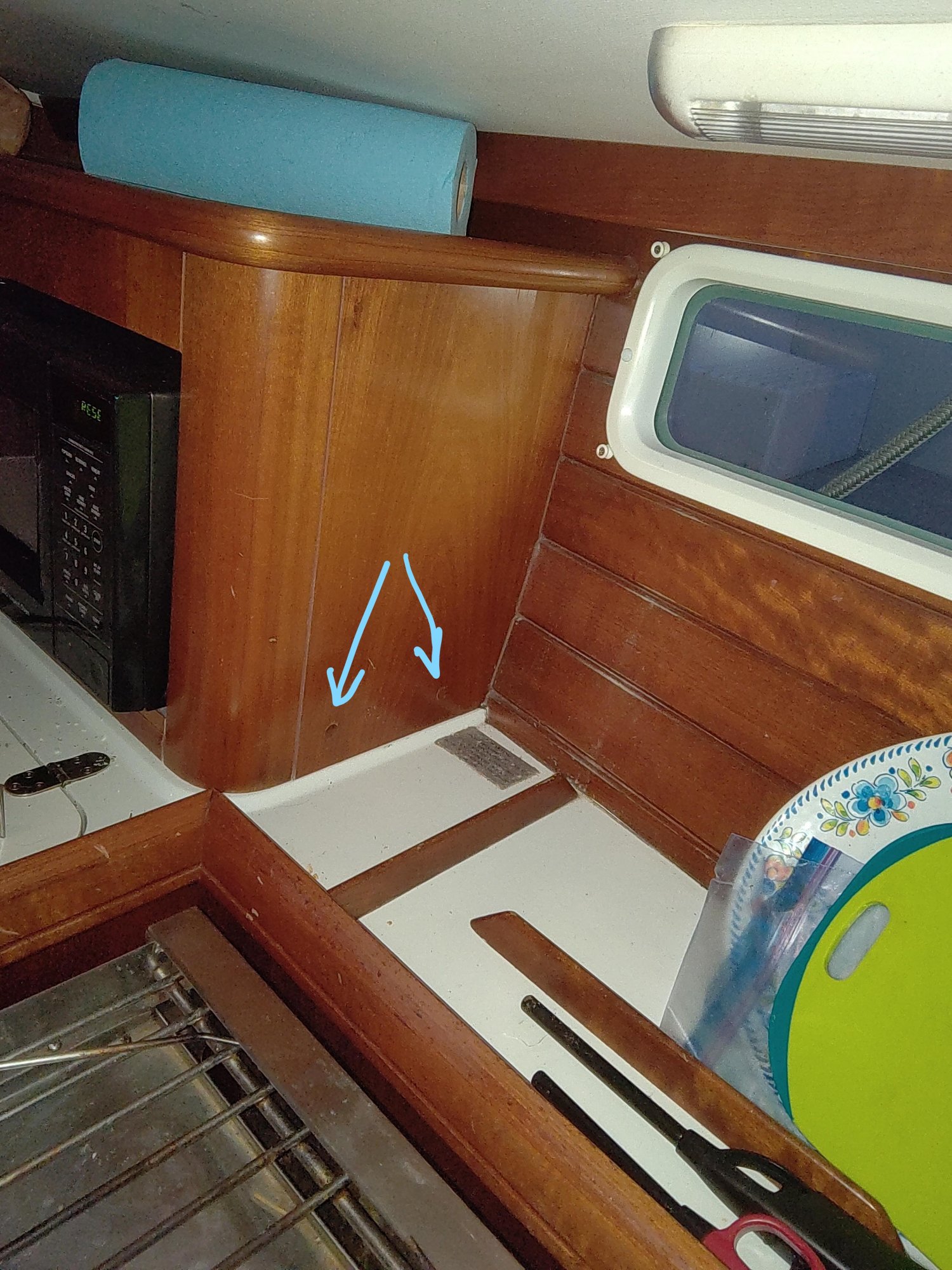

I need to replace the cooling system in my fridge (evaporator, compressor, pipes). I am trying to find out how to get to the place between the fridge and the hull where the current pipes are laid out. The most promising candidate is the wooden side on the side of the microwave (see picture). Seems like I would need to drill out the two marked plugs, unscrew and (hopefully) take this wall out. I am a little concerned that perhaps something else is still going to hold it, like the wooden slats on the inside of the hull wall. Has anyone done this? Any advice? (this Beneteau 46, year 2000).

The two plugs turn out to be removable by hand. They cover holes that seem to end on the microwave sidewall. I am now wondering how does one remove the microwave. The wooden wall is not removable. Perhaps I can access the back of the fridge from under the microwave, if I can get it out. Any ideas?

In a couple of Beneteau's and mine the microwave was held in place by 6, double sided sticky rubber pads.
