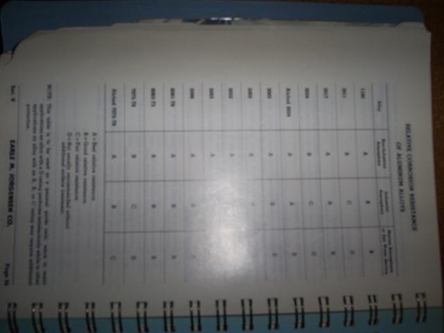

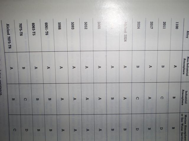

Bob, why did you choose 6061 for this? I just built a triple clutch out of 6061, but a machinist friend of mine gave me a reference manual on metals, if you can fine 5005, 5052,5083 or 5086, they are listed to have better corrosion resistance in a marine enviornment. I made a little pedestal for my chart plotter out of a lesser alloy aluminum and it was pretty well corroded after a year. I hope the triple clutch holds up with out me having to anodize it. If it corrodes I will anodize it because it was a lot of work. $10 worth of Aluminum, but 10 hours in the shop. lol I even took the time to install Igus inserts so my cams will stay pretty.
I attached the page that lists the different alloys and their rating. 6061 is a B rating, where the others I listed are an A rating with no other coating or anodization.
The second page is just a better photo of the book, the first didn't come out well.
