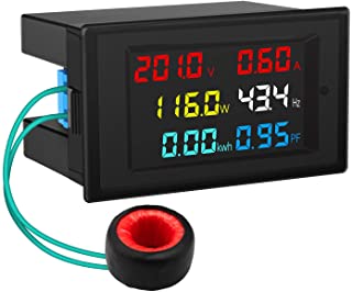

I installed one of these as I can now see what is going on just like the battery monitor.

look on amazon. what i like is the information it gives.
