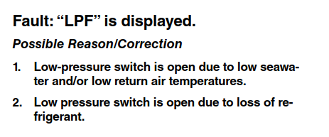

This fall my wife and I purchased a 2005 36. During the sea trial the air conditioner reported a “LPF” error. The AC is a Marine Air Systems Vector Compact.
I am wondering if correcting this error by recharging the system is DIY project or do I need a HVAC technician? Has anyone else dealt with this error? Can this be caused by anything other than low coolant?

I would check your seawater pressure switch first, before looking at freon, a unit that young should not be experiencing freon issues.

Yes, common thing. You prime the A/C seawater pump and restart the system.

I do not believe there is a "seawater pressure switch". There is a low pressure switch in the gas or freon system. When the freon pressure drops below a set pressure it shuts down the system and displays the trouble code "LPF". If you were testing the a/c system with the boat in very cold water as you have in WI in the fall, the raw water may be so cold as to lower the pressure of the freon to the point the low pressure switch closes. Until the raw water warms up it may not be possible to get an accurate reading of the freon supply either by the "LPF" display or even if a set of refrigeration gauges are hooked up by a technician. If you could supply the raw water circuit with warmer water, around 60 degrees, then you could start to get an accurate reading of your freon supply.
I suggest you wait until you can supply the raw water circuit with warmer water and see if the system runs without the "LPF" trouble code. If you still get the trouble code you will need to attach refrigeration gauges to get an accurate reading on your system. It is not possible to correctly charge a system without.
