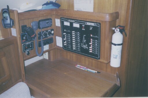

The AC/DC tv's use about 10% less power in the DC mode than in the AC mode. And then when you add an invertor in to the equation, you have a power loss there. I think that the invertors are about 70% efficient. I have an invertor on my boat and a AC/DC tv with built in tape deck. I put a DC plug along with a antenna jack at the TV location and run on DC. The DC plug is just below the Heart Invertor Control Panel on the left side and the TV coax jack is next to it. The TV sets on the chart table when in use.
