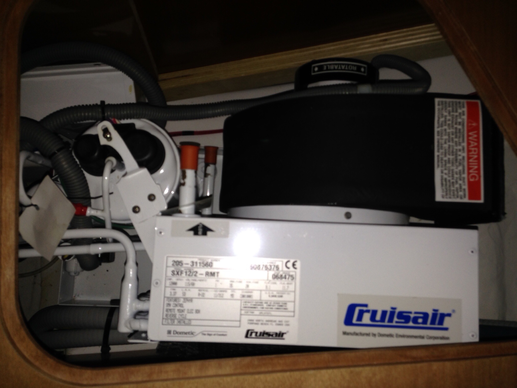

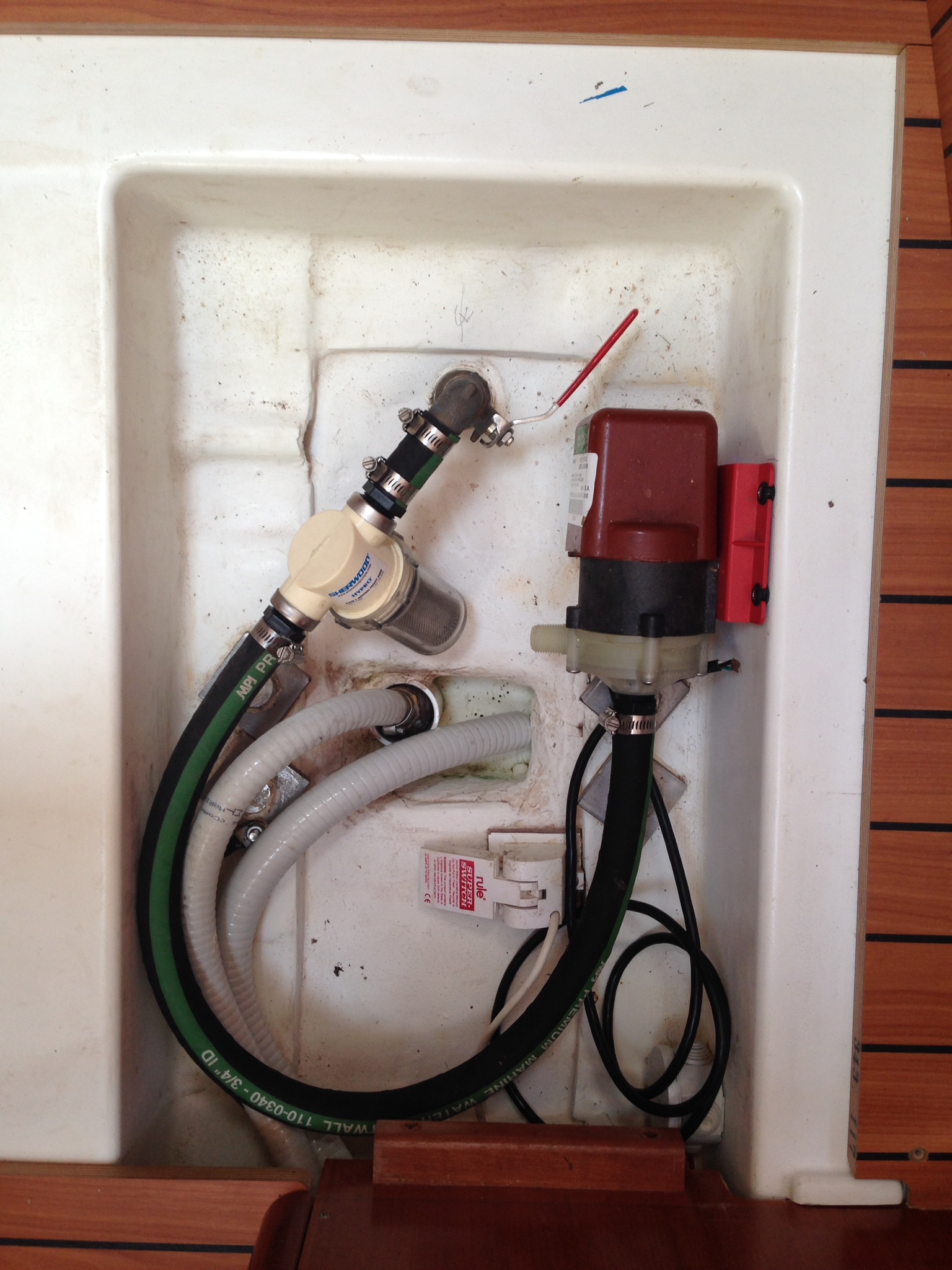

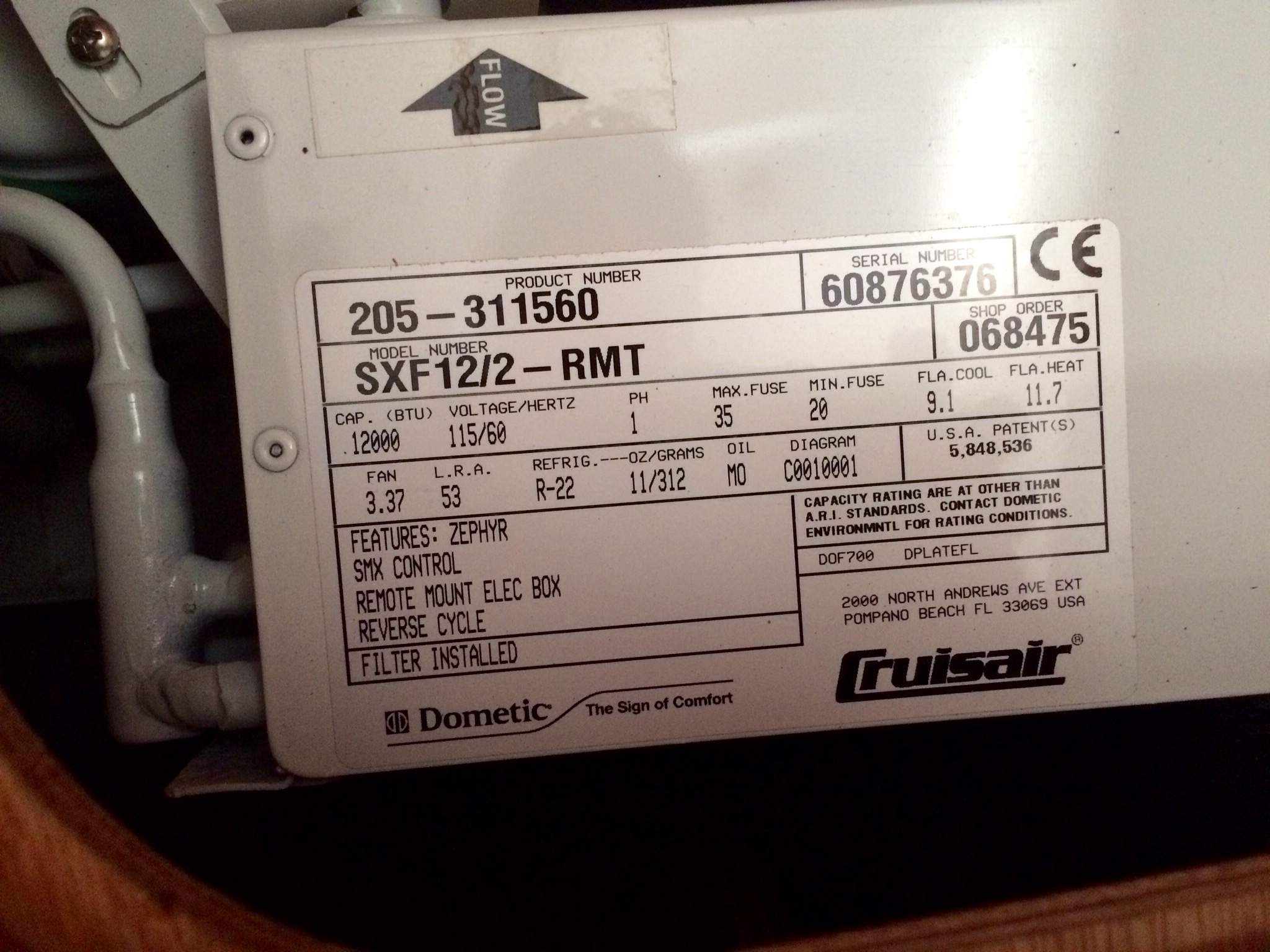

John, I will attempt to attach pics of my Cruisair 12k BTU unit. It is partially installed on my 343 and located under the aft end of the port settee, directly forward of the galley counter. The other pic is the intake valve, strainer and pump.

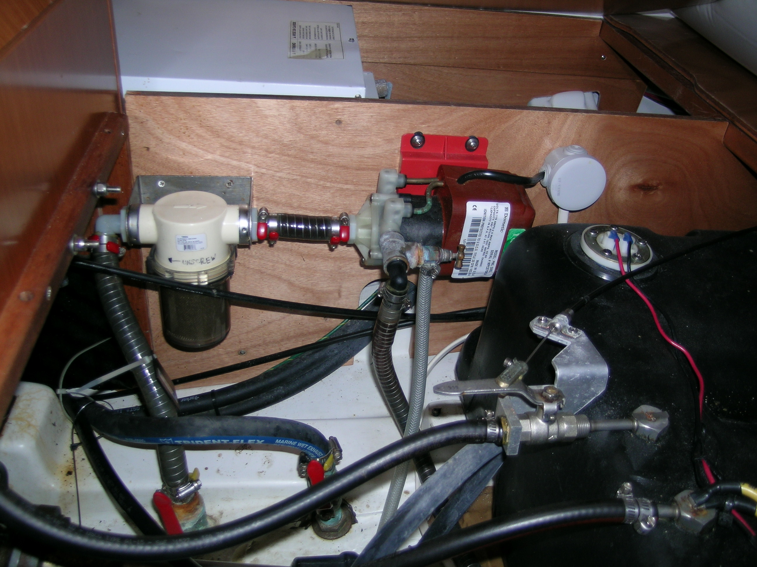

I don't think that is a good idea to install an AC powered pump in the bilge. Also that location would involve drilling a hole thru fiberglass grid/pan to get the outflow to the air conditioning unit in the port setee. I will try to attach a photo of the factory installed intake, strainer, & pump located beneath the aft berth close to the water heater. Note how they have the pump mounted completely out of the bilge. Hope this helps.

Another idea, if you decide to install the pump & strainer under the aft berth. You can install a "Tee" fitting on the existing engine raw water intake thru Hull & ball valve. That would eliminate another thru hull fitting. Just route the hose for the circulating pump intake off of the "Tee". Cant see this being a problem since you aren't going to be using the air conditioner while motoring (unless you plan to install a generator). This would also be a good opportunity to change the thru hull & valve to good quality bronze fittings; Beneteau is notorious for using brass fittings.
