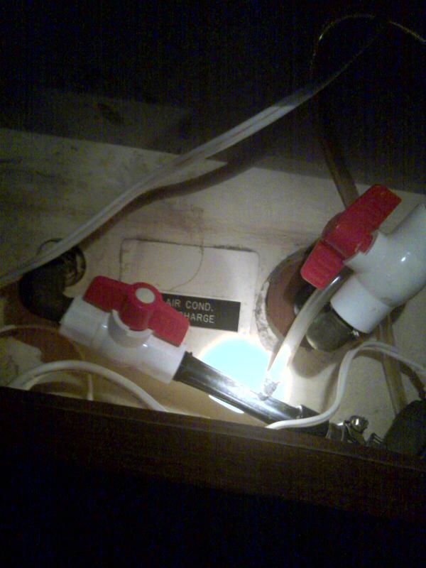

I am guessing that is from your AC and the venturi gets hooked to the AC pump before or after the pump,hard to see what you have there with the shut off values.
That is on my list when I return to Florida and we leaving NY today heading home finally.

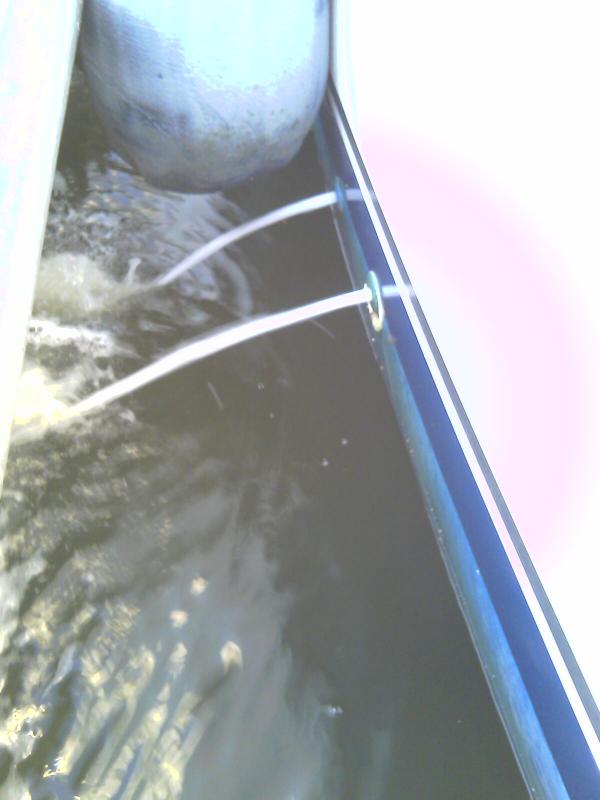

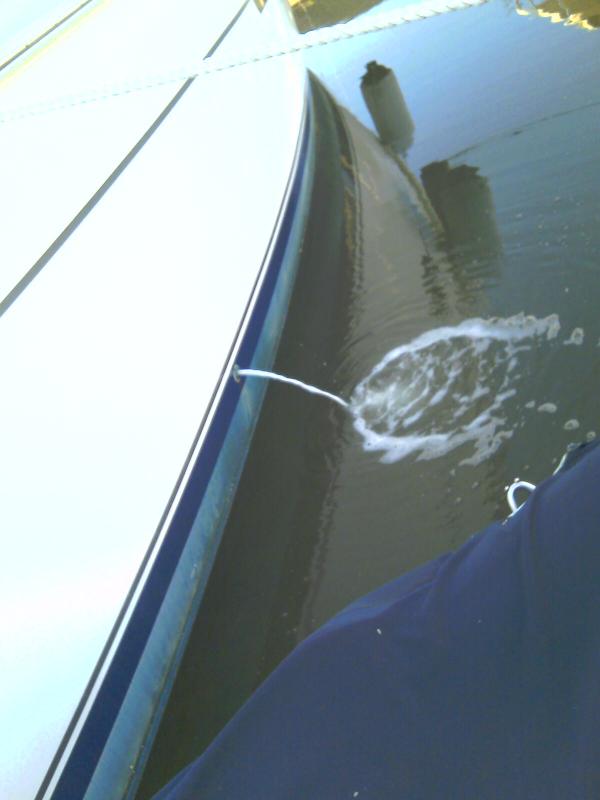

These two a/c discharges are above the water line and attached in a protected location behind the salloon cushions. The only time they go under water is when I am sailing. And only go under when at about 5 knot on that tack. They have been operating this way for the last 7 years with no problems. These seacock valves you see I have been using in various other situations for many years and they have proven to be much more reliable then the 400 percent marine markup metal valves. The ones that were first installed on this boat all failed with in the first year. These valves you see I found at home depot about 12 years ago, Not one has ever corrodied,cracked,jammed or failed to do their job in any way.
Now if you are not comfortable with this location for the a/c raw water discharges Then a more Ideal location for discharges would be to move them to the location of the main bilge pump discharges which on my boat are at the stern on the port and starboard sides. In this location the thru hull discharges never go under water.

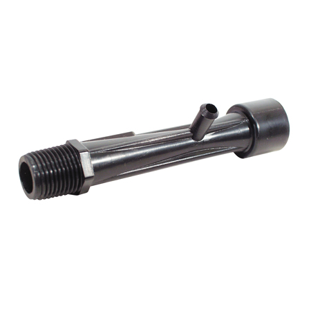

attach venturi directly to the above the waterline discharge
That is interesting....My discharge stream did not seem to change that much. The stream just changed to a frothy white once the venturi had sucked the pan dry.
Questions .... Did you attach the venturi directly to the above the water line discharge seacock valve and then the discharge hose to venturi? Also what type of raw water pump do you have? That could be your problem.

Onecoolair- I didn't pout the venturi directly on the seacock- instead its inline of the hose that runs from the ac unit to the discharge. It is above the waterline. I does create good suction- it pump out a tall glass of water in about 10 seconds. Your probably correct about the pump. I don't recall which one my mechanic installed but I do remember he said he didn't purchase the pump from mermaid.

I also tried the mermaid venturi. Had it installed in line just above a/c unit and only 1 to 2 inches above water line. It seemed to work for the first 8 months or so till there check valve malfunctoned. Good thing I was there when it happened. Otherwise my boat would have sunk. The thing back siphion and started filling up bildge. Removed the mermaid valve and fancy verturi to clean it. And it exploded in my hands. Small bebes and springs and some other small mystery dodads shot of somewhere in all directions???
That was a total 250 dollar ripoff as far as I am concern. Mentioned what happened next day to a neighbor . And he showed me what he had done.
As it turned out the new venturi I found at the saltwater aquarium store had male and female ends which matched up perfectly (even the proper direction) with the seacock valve I was using and the fitting on the discharge hose that was screwd into it. "See pictures previous post". I have not had any problems since. And no check valve has been needed.
BTW....I would recommend sending the unused mermaid venturi back.
What would be nice is if Marlon or someone would make this simple designed venturi in a higher grade plastic composite or anti corrosive metal . Now that would really be a home run. But so far this "simple" plastic venturi has proven to be very reliable and maintenance free. As well as the red handled resin ball valves I found at home depot that I have been using as replacement seacocks for the last 8 years with not one single failure or need of replacement.
