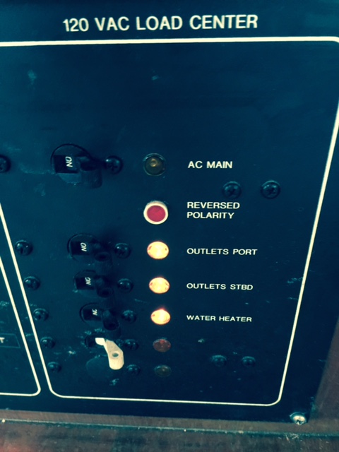

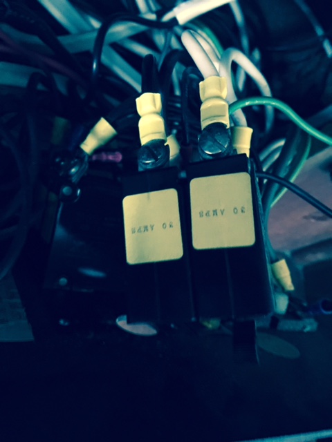

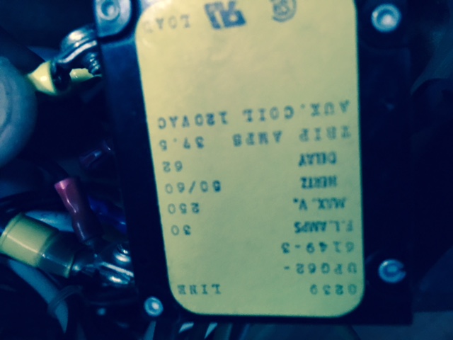

I have a Hunter 34.5 model year 1983 and my main ac breaker in the panel that switches polarity and turns on the amber lite on the panel has failed. it is an unusual configuration behind the panel it appears to be 2 -30 amp breakers glued together but only one black toggle pole to turn them on. Initial research does not show that the same breaker is not available through sea anyone have the same issue that the breaker is available but a single 30 amp not two attached together with one off on toggle post in black. WHERE DO I FIND THE ORIGINAL BREAKER?

try paneltronics they have just about anything you need in the way of breakers or type on the part number of that breaker in google and see what pops up

Are the other circuits working? It looks like the indicator lamps are on for the others?
If so, then only the "AC Main" indicator lamp is out. That breaker turns on the AC from the shore power to the boat systems. does not switch polarity. The red indicator lamp shows if what you've plugged into on shore has reversed polarity..
The breaker is a "two pole" which in this case breaks the white and black 120 V wires ..so that boat would be totally disconnected even with reversed polarity.

thank you, the switch was on the way out, i had to switch it back and forth a few times to get the yellow lite to go on and the 110 vole battery charger panel is showing fault in constantly now it use to go through the battery bank and only one bank had a fault. I ordered the switch and will see what happens. I also noticed that one of the pins in the shore power hook up on the boat had a rusted corroded pin close to the plastic. It may have had a faulty connection at one time causing it to discolor? is that possible?
