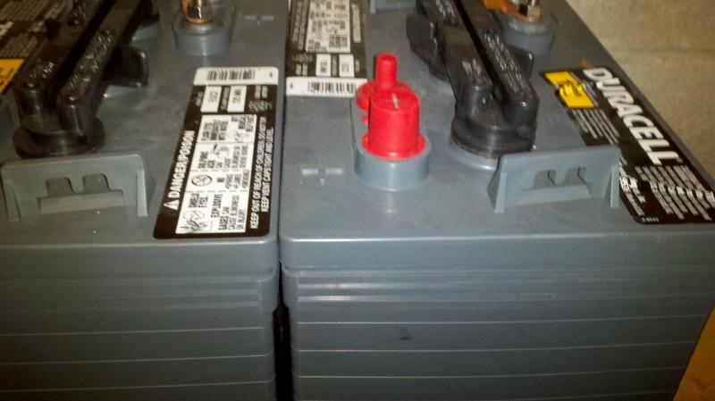

As you know I took your advice and went to Sam's. Bought two 6-volt DuraCells rated at 235 amp-hours. So I am wondering if I should cycle them once. What do you recommend, a load that will take them to 50% in 20 hours? What do you use?
There is no handle or convenient tie-down for these batteries. Those tabs look like they are made for something special.

12.66 you are right on the money. What is the manufacture date on those batts? Did you charge them? It seems to me that if they are charged almost to 100% they must not have sat on the shelf long. I would not worry about cycling them just put them to work. The tabs are probably to attach hooks for moving them around at the factory.

Those are carry strap hooks similar to many other brands. The strap looks like a heavy rubber belt with the appropriate hooks. Not familiar with fuses that bolt directly to the post(s) but as long as they are insulated from the inadvertent metal object, go for it.

The hooks look just like the 6 volt batteries I have in my motor home which just happen to be bad and need replacing,so what was the cost of these durcell 6 volt at sam's club,I am up in NY where I keep my motor home and will need to replace them for sure.

Those tabs
Those tabs make great lifting points. A 3-foot chunk of 1/8" utilty cord, run through both tabs in a loop, and all of it in your hands (the center part and both ends -- it ends up looking and feeling kind of like a sachel handle) makes lifting and carrying those brutes a breeze. A sail tie would work even better, but I can't bring myself to do that to a sail tie.
Yes, they make slick rubber carrying straps, but who wants to spend the scratch -- and then store it for a couple years?

Re: Those tabs
I questioned those because the edges are so sharp. They feel like anything through that slot would be cut or, at the least, fray quickly. Looking for a way to tie them down. Where they will sit a box is not necessary and will not fit. The straps that are already there were securing AGMs. Now I have the caps to deal with and the strap would go over the "whatchamacallit", three cap opener. I guess I can make something that goes from the tabs down to the hold down.

put a piece on wood on top as a spacer to protect the caps and just strap the babies down, not that big a deal loosening the strap when time to check the water
