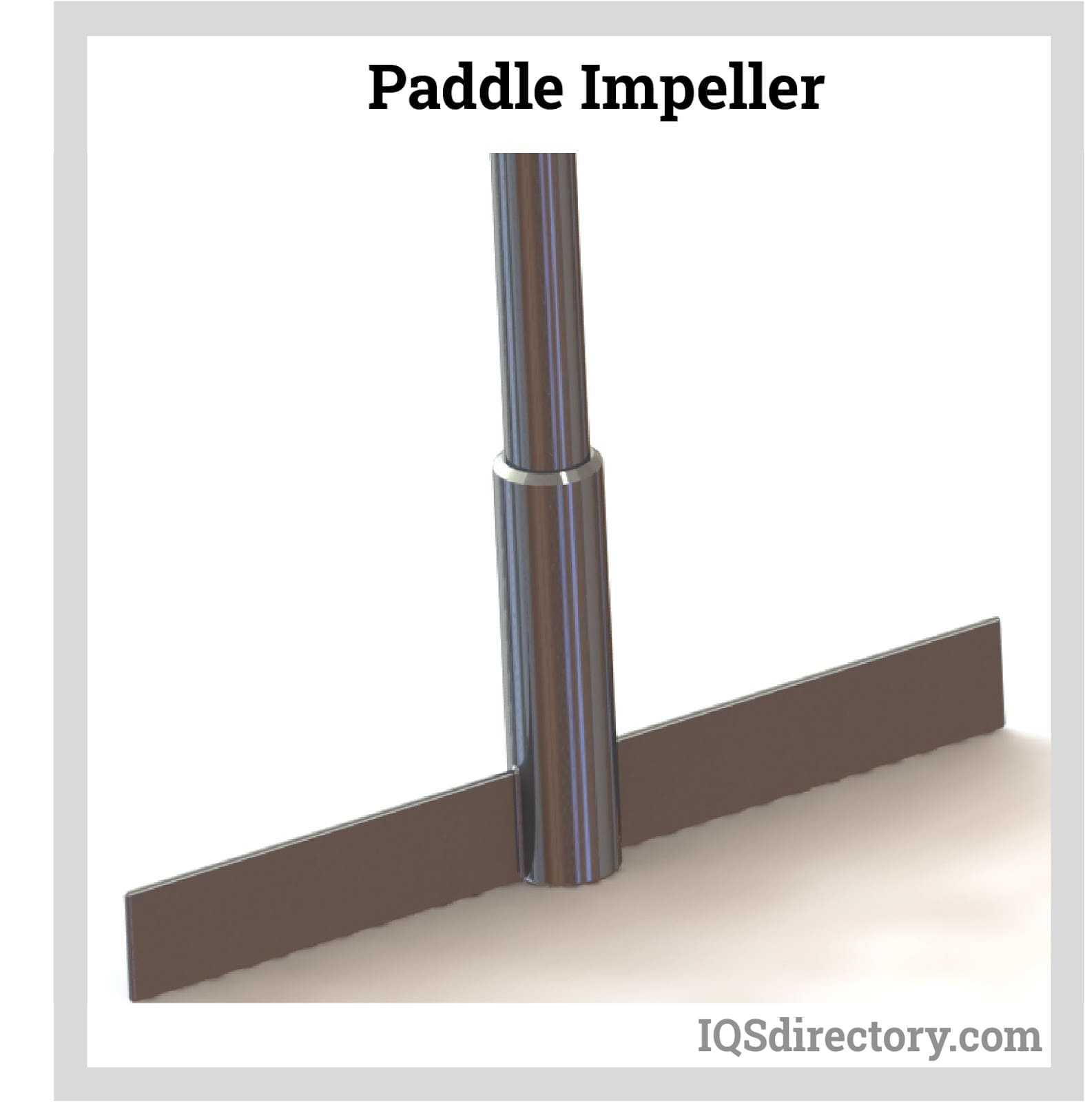

I assumed you thinned with water. This has to be done at high speed, not your typical cordless drill. It also depends on the mixing blade; most are not effective for this because emulsifying is not their purpose. Paddle impellers, aka axial flow turbines, work best. Difficult to buy, I made some of mine.
