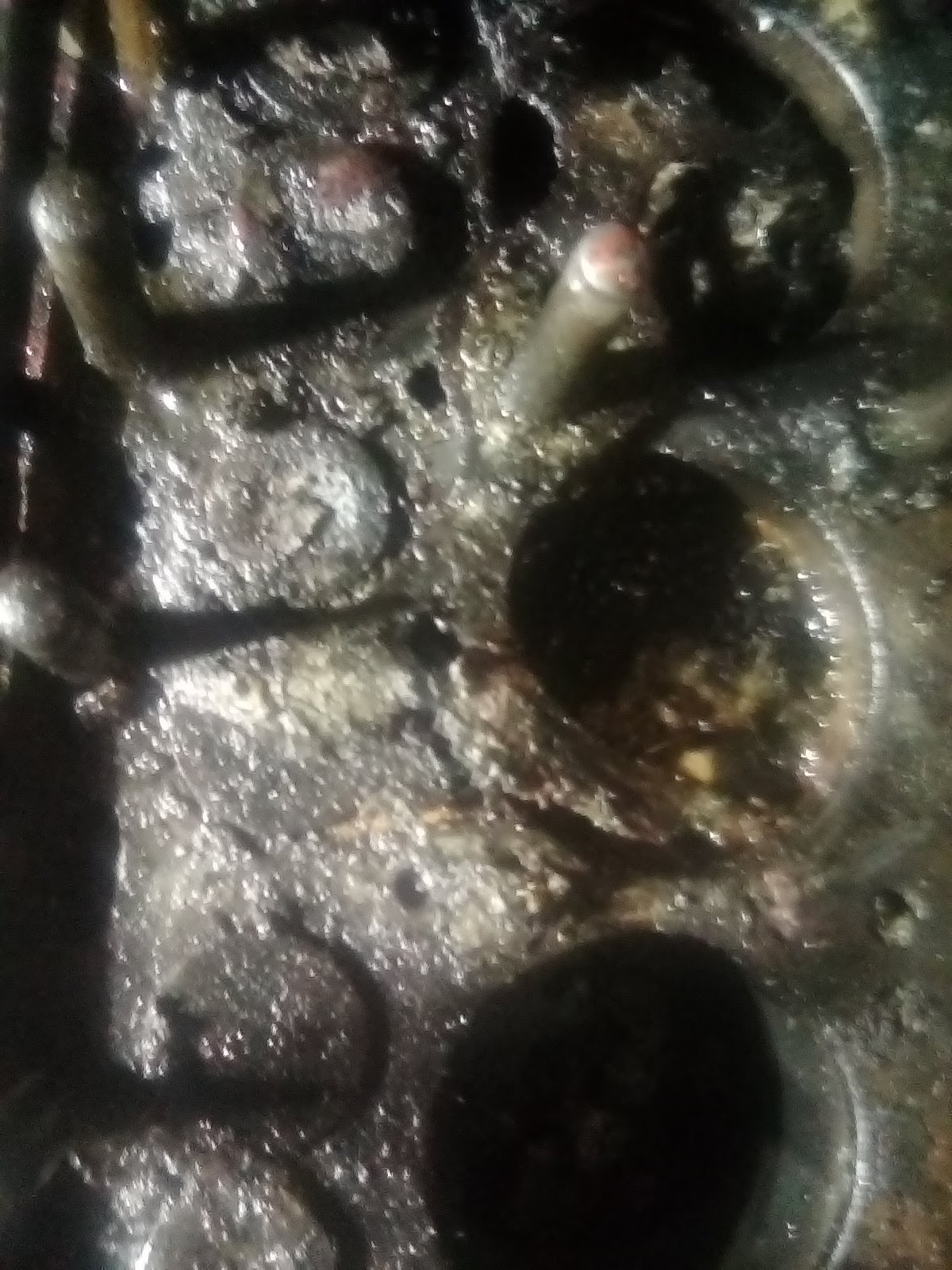

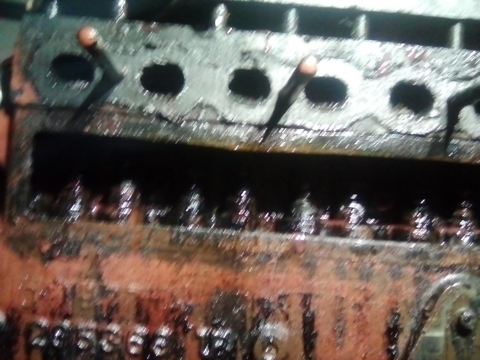

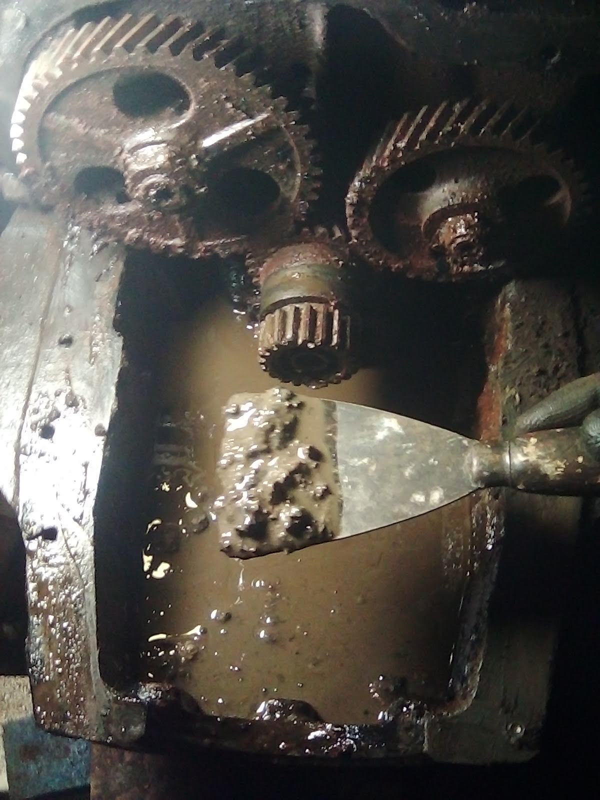

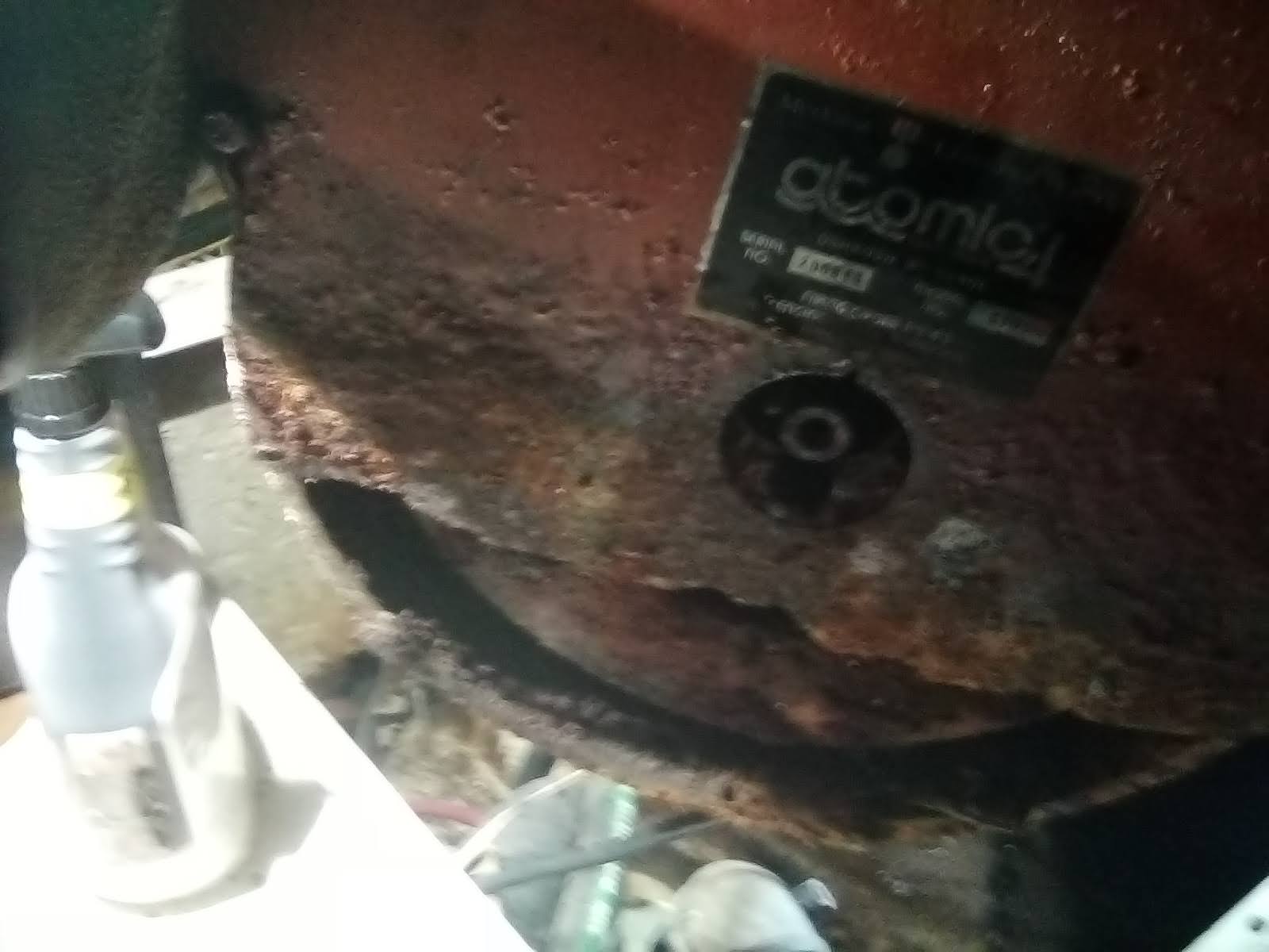

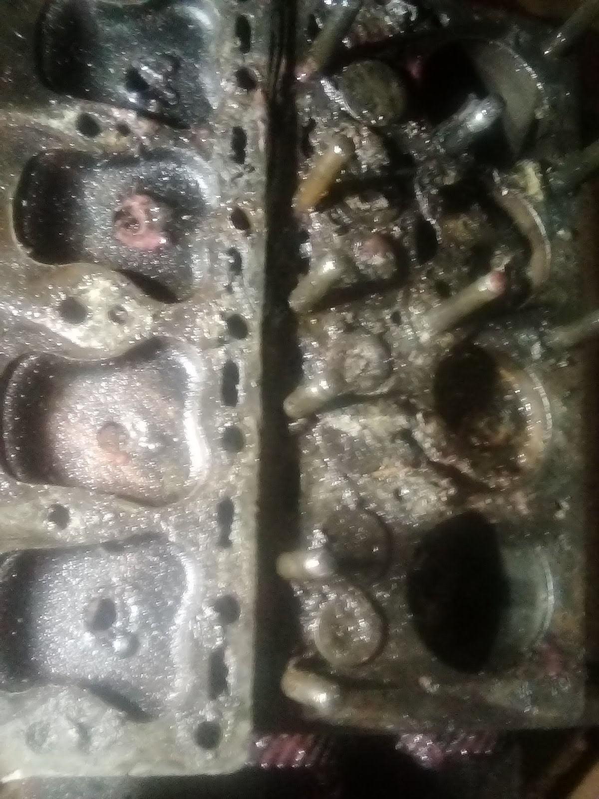

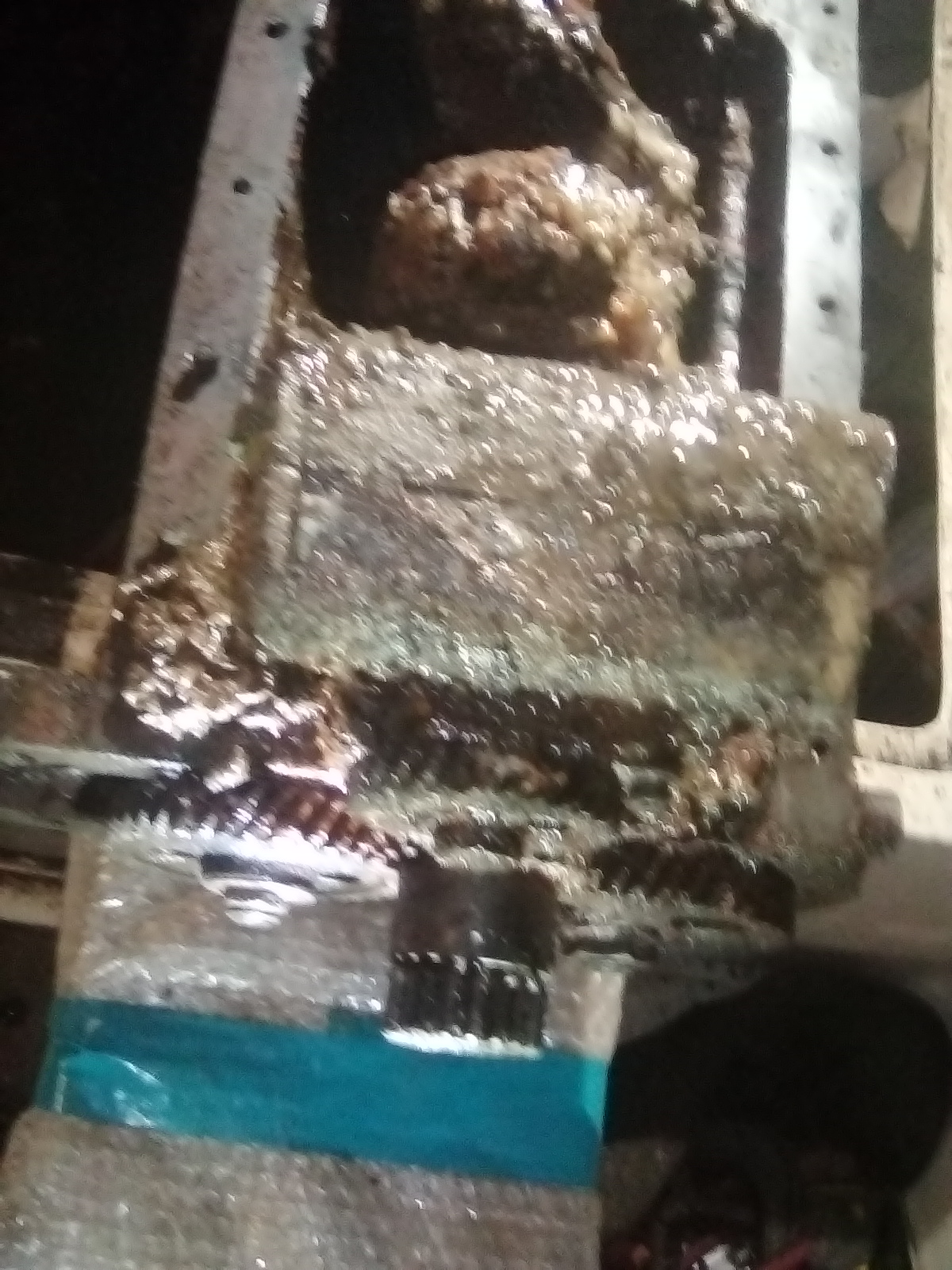

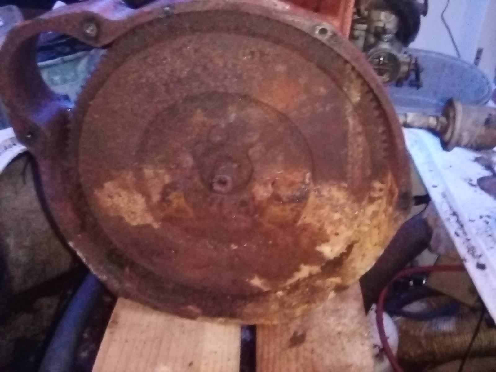

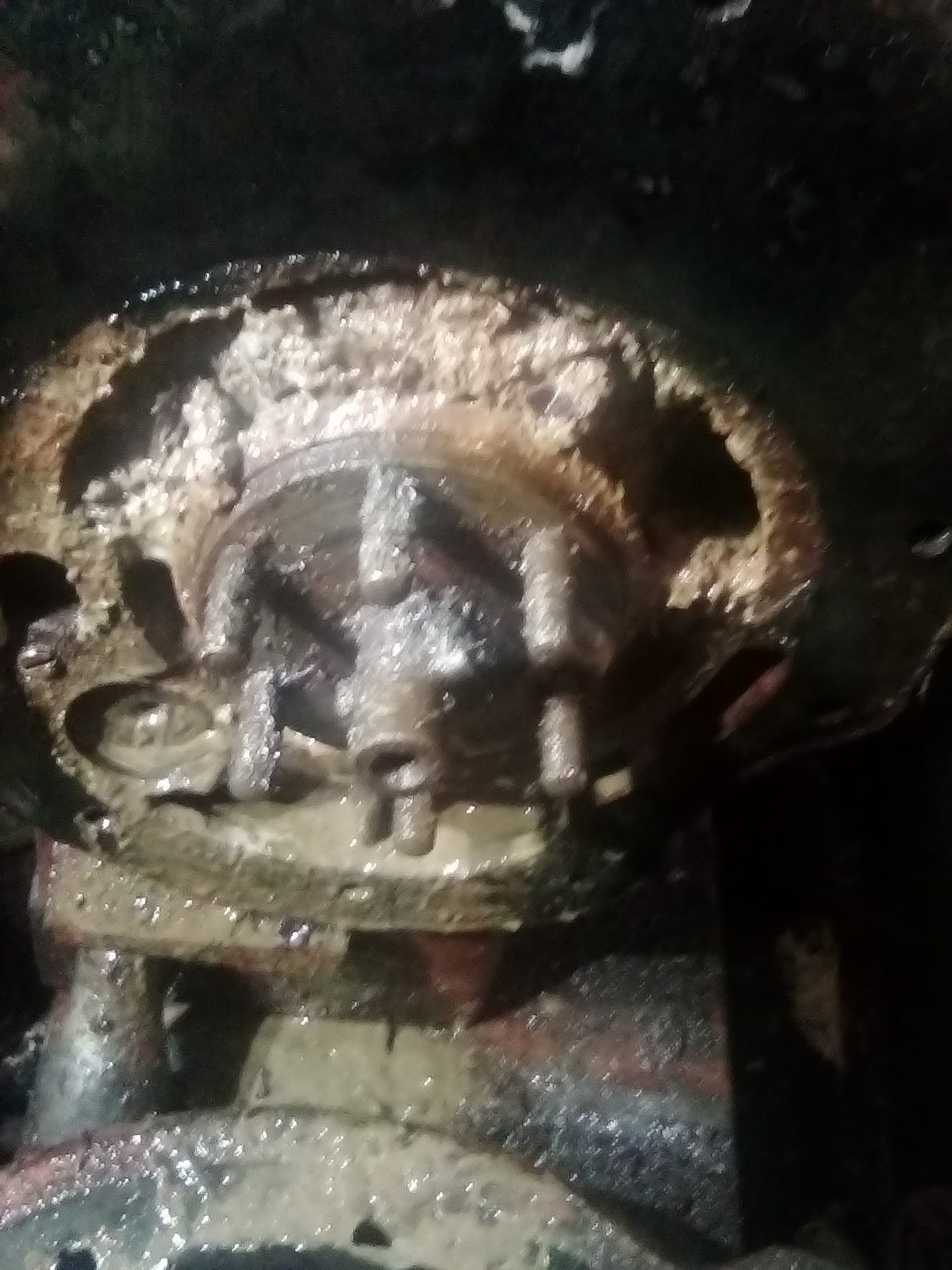

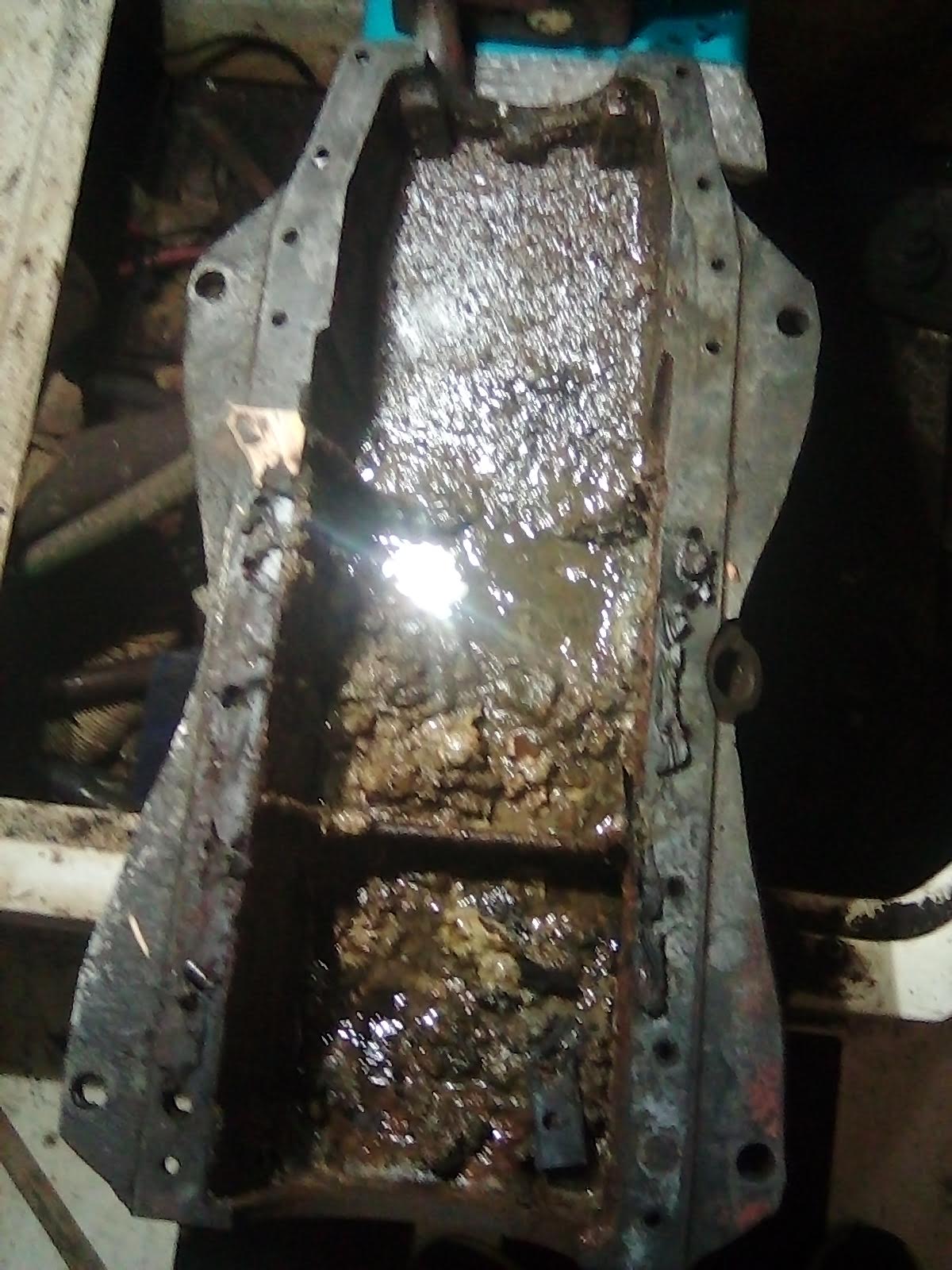

Well I thank You for the welcome and all of Your responses and inputs after dealing with this project I picked up to keep busy during pandemic all sorts of alternatives came to mind I don't know if any of Your baby's diapers had ever been this dirty and the further I tore down the more the complete M-35 in my mind would fit and it actually is not that far off but I'am a stubborn Irishman and cannot let this A4 beat me at this point and follow through putting her back together especially since I have already bought almost all kits possible and I think assembly will be a lot more pleasant than the teardown and maybe I'll be Sailing by summer. Thanks again Take Care Be Safe Patrick Who lets an engine get this way???
