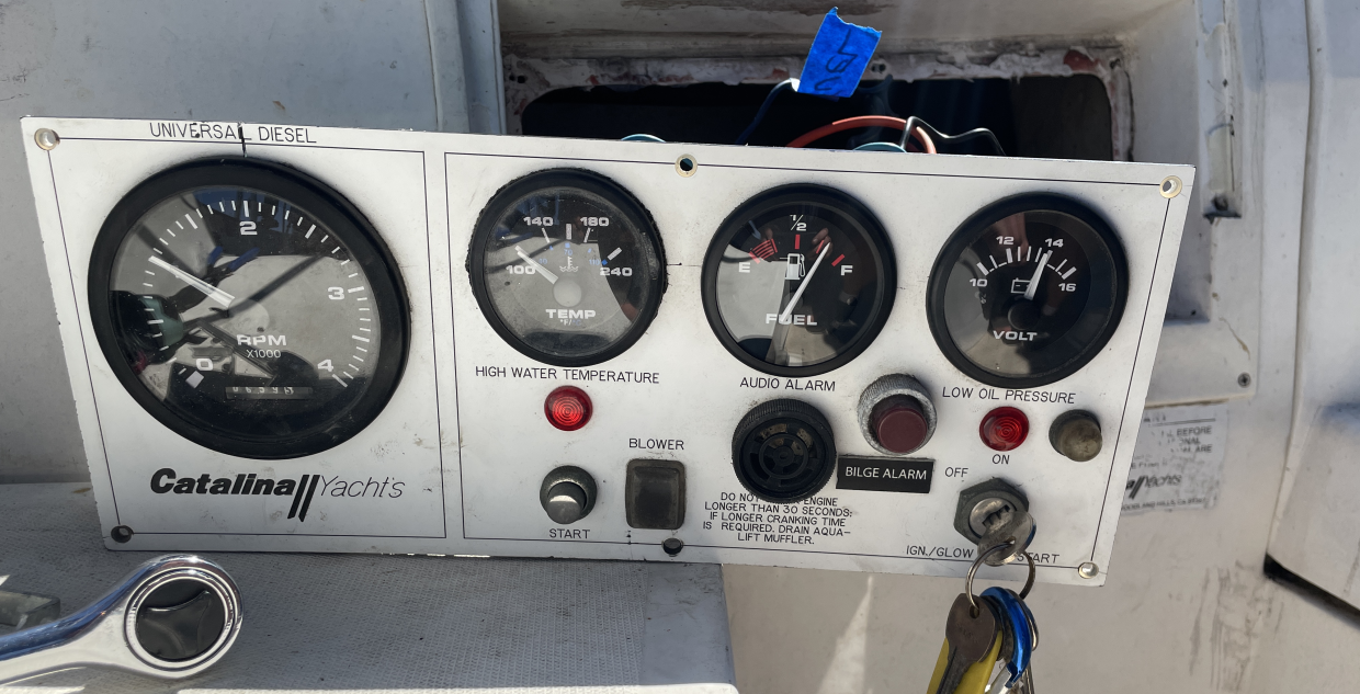

It started with an oil pressure beeping issue. I recently had very quiet beeps out of the sounding device at the cockpit control panel while underway, but couldn't figure out any issue with my oil pressure. I changed the pressure switch and tested it with a pressure gauge to confirm it was good. It was. First off, the pressure switch is just that - an ON/OFF SWITCH. It shouldn't be able to provide a slightly resistive connection to ground to make the beeper quietly beep.

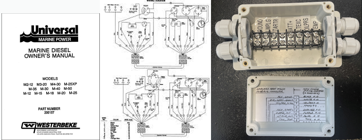

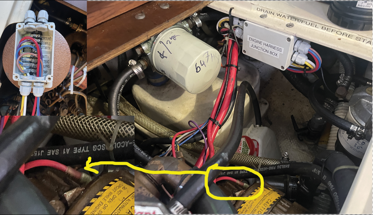

I made a box with a marine terminal block inside it. My plan was to replace the trailer plugs with this.

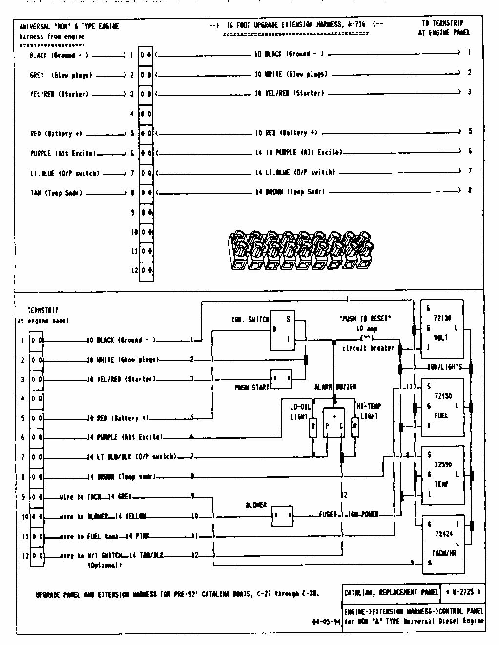

Another issue I had were wiring diagrams. Even in the on-board manuals set I had on the boat, everything was the same generic manual with the same wiring diagram:
The problem for me was that it was hard to understand since I didn't have an Ammeter (both diagrams show an ammeter) and I didn't quite understand what all the alternator wiring did. So a diagram that wasn't exact was very confusing before starting this project. I did finally find some diagrams that matched my setup in what used to be the upgrade instructions from the old setup to the new setup. These diagrams made a lot more sense, and matched what I had already. I could now understand the wiring I had.

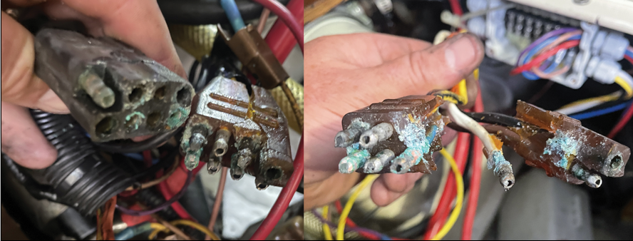

So, I started the process. Man, those trailer plugs were BAAAAAD... The connector was nicely taped up and zip tied so it looked good from the outside, but when removing the tape and zip ties, this is what I found. The connector was split literally from corrosion exploding it from inside.
I'm pretty convinced at this point this is why the oil pressure beeping would happen without the switch involved. Made sense now.

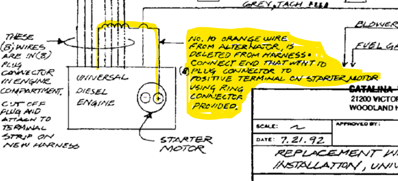

While wiring it all together, I found this piece of info in the harness upgrade instructions:
It said the orange wire should no longer be connected to anything. Wait a sec, I thought... I have an orange wire connected to the alternator! I'd better wire it like it says in these instructions! Thinking I'm doing something good, I make a nice red jumper to from the Alternator to the Starter.

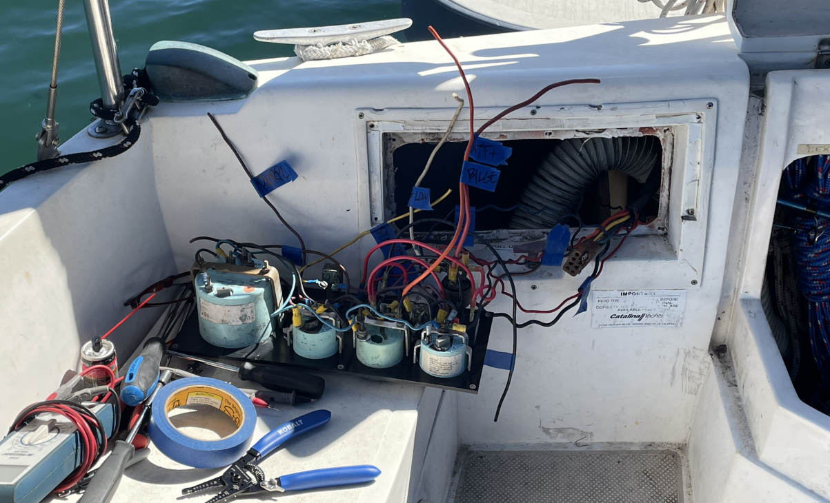

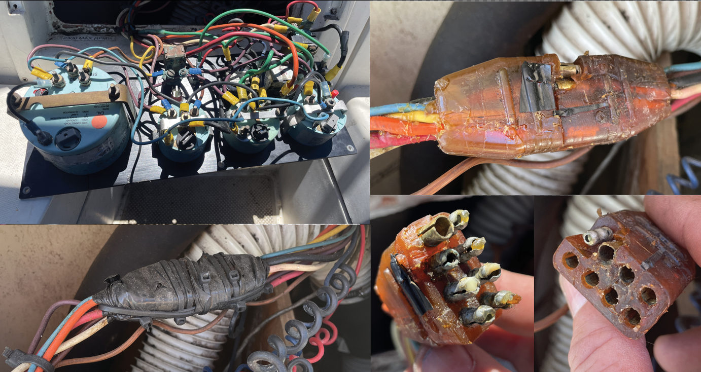

Here's what I found behind the gauges. Some gauge connectors that should be cleaned or replaced, and a bad trailer plug again. It wasn't as bad as the engine compartment, but still not great. I didn't want to spend the time to build a box for this end, so I planned on using a standard barrier strip like in the upgrade instructions.
I took the time to label the gauge end of things, and then this is where it got weird. I wired it all back up to a barrier strip, and I replaced a few of the wires and connections behind the gauges, but when I put it all back together, none of the gauges worked!!! WTH???? What could I have done wrong???
Thinking I did something wrong, I started metering everything. It wasn't easy to figure out, because a lot of the gauge sender feeds, starter, etc all have low resistance to ground and show continuity to ground on the meter. Okay, I'm confused now. What did I do wrong?
I made the mistake of spending a late night trying to troubleshoot it all in the dark. Now the engine won't start! Wait a sec, I have gauge problems now and the engine won't run. UGGGGHHHHH! It's midnight, I'm going home, will try again in the morning.

So, looking around I discover that the bilge buzzer was using an orange wire. Wait...I disconnected an orange wire from the ALTERNATOR? Ah ha, there's ANOTHER orange wire down there, and I disconnected it thinking I don't want any orange wires going to the cockpit panel because all the wiring diagrams show the orange wire being used for Ammeter stuff. I realize that the bilge buzzer used one of the TWO orange wires that were bundled in the engine harness. Okay, got that figured out.
But what about the tachometer?? I CANNOT find any tan or brown wire going down to the engine area except for the TEMP sense wire which I have already verified. But there is this second Orange wire that I cut from the alternator and replaced it with a red jumper to the starter. Could it be that? Oh crap, yes, that must've been the tach wire?? I made a test jig to test tone out the wire and sure enough, that brown/tan wire at the tach gouge somehow becomes orange in the engine compartment.
Needing a new piece of wire for the engine compartment, I went to WM to find something tan or grey in 12-14 gauge. Nothing. But they have ORANGE! Damn. Okay, well, I guess I'm putting back the two orange wires I thought I didn't need as orange wires again. LOL.
I un-fixed the red jumper and reconnected it to the orange wire that I now know is the tach input.
Catalina Harness Connector Upgrade WikiSo, I started the process. Man, those trailer plugs were BAAAAAD... The connector was nicely taped up and zip tied so it looked good from the outside, but when removing the tape and zip ties, this is what I found. The connector was split literally from corrosion exploding it from inside.
