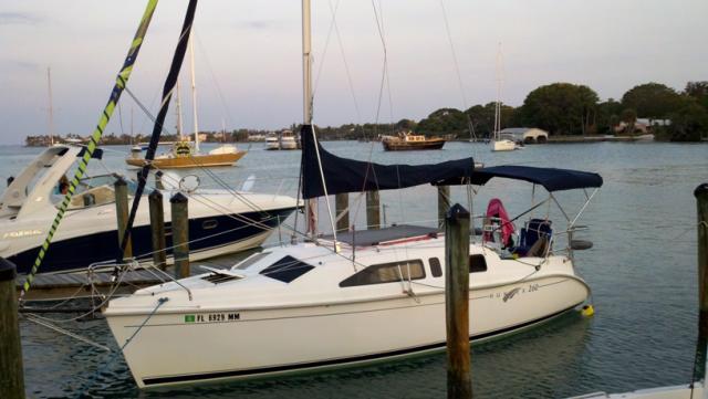

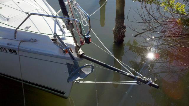

Although it's running off the intent of the original post slightly, after considering all the options we added an A-sail on our h260. I have it permanently deployed on a 4' bow sprit and a Facnor continuous line furler that has a furling line run back to the cockpit.
It's a nice bump up from the stock jib and the boat actually points almost as high with the A-sail.....almost. It furls in a snap and I can easily single hand it with no problem. It's of little use DDW or if the wind is above 12kts as the main is especially large for these boats anyway. To keep a 260/26 on its feet it will be one of the first to reef when the wind picks up a bit.
The stock plastic crap spinnaker block for our internal halyard blew apart almost immediately so I'd look for a tougher one if you intend to load it up hard.
As mentioned, a symmetrical sail will add some juice on light downwind runs but the issue is flying it out in front of the 260/26s' fairly large and roachy main. Aside from the big colorful chute factor, any added speed bonus is greatly complicated by the added crew and gear on a boat with a pretty well designed(simple to use) set of stock sails for it's use.
