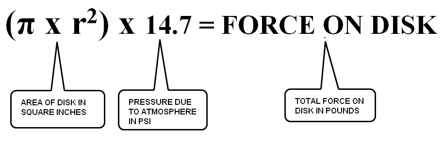

Time to do some arithmetic and see where the problem lies.
We don't know the size of the engine but let's say that the air intake is 3.0" in dia. If the engine air intake were able to pull a perfect vacuum, the internal pressure would be expressed
as 0 PSIA (where A means pressure above a perfect vacuum.) Now atmospheric pressure is 14.7 PSIA (14.7 PSI above a perfect vacuum.) The force across the 3.0" dia. plate would then be :
(π x 1.5 x 1.5) x 14.7 = 104 pounds force
Either the metal plate was made of tin foil or the size of the suction was much larger in diameter to cause the disk to collapse. If you wanted to design a dedicated plate for an air shut off, this is where you would start to avoid collapsing the disk as @capta witnessed. Most likely easier to use a damp towel. The whole towel is just not going to fit inside the filter housing.
