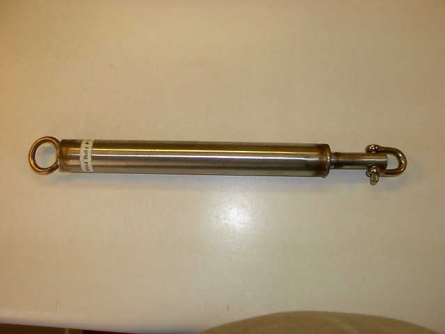

Wind Bully
The previous owner of my Hunter 26 had a device called a Wind Bully. This device looks something like a cross between an automobile shock absorber and a small pneumatic door closer (see attached photo). It attaches inline between the mainsheet and mainsheet tackle. It supposed to be stiff enough to not extend out during normal wind, but will "stretch" out up to 8 inches during a sudden gust, then return back to its retracted position. When I bought the boat, the device was already damaged during a tropical storm while on the hard and was unusable. The company is no longer in business, but it sounded like a good idea. BrianW
