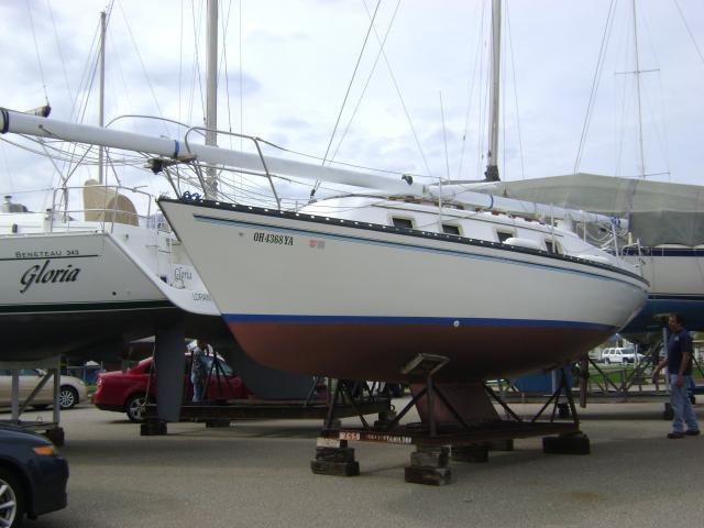

I bought a 1982 Hunter 27 late last season. I have been doing what I can through the winter as far as projects, I replaced the sink drain and thru hull in the head, I repainted the bottom, did a serious polishing on the hull and I have rewired and replaced the lights on the mast. I also ran new halyards since the mast is down. In the process I found the compression post rotted at the very top. The deck is solid from what I can see. I am rebuilding the post and plan to install it tomorrow. Anything else I should look at with the post before I reinstall it? I feel a slight depression in the sole where it sites but it is less then an 1/8 of an inch. The deck is flat when the mast is in place. Figured I would ask BEFORE I install her new post! She gets launched this week!

The post sits on the liner so it is out of the bildge and stays dry. I will check the cross member when I go back tonight. I would like to do a SS post down the road but for now this was more cost effective. The post was completely dry so I guess the leak had been repaired by the PO. I can tell that it came through the area around the wire conduit which I will reseal and then reseal the wires in the conduit when I set the mast. I came to the length because the one part of the post was still in good shape and had not rotted so I took that length and added an 1/8 of an inch for the slight imprint in the sole floor. there is a screw that secured the post to the cross member and when I removed it it was tight and solid so I can assume that the cross member will be ok (I hope!).
I made the post out of some wood I had which is Maple and White Oak. I had planned on slapping something on the ends before I put it in.
George, funny you say that about the head sink. The thru hull was cracked and I saw that the first time I had it out last year. I broke it clean off trying to pull the tube from the sink. Needless to say that has been done! I also noticed the deck drains are split, those will be next but I need to get her moved this week so they will have to wait!
